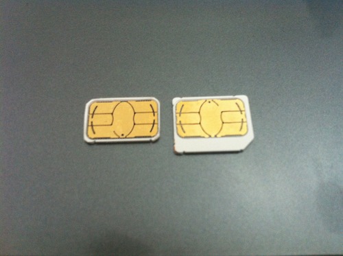

Just wondering weather the micro sim can be cut into a nano sim whilst still regaining functionality. I read this in which the manufactures said that it is not possible as the nano sim is 0.09mm thinner, but surely you could just shave that off the back with a little sandpaper. I have a spare micro sim so I'm going to give it a try now!
I know I've still got a bit to go around the edge but I think it'd definitely be possible if I had an iPhone 5 sim tray so I can keep on popping it back in to see when it's the right sort of size...
Yeah but it's only 0.09mm difference, you can take that off with a couple swipes of sandpaper or with a nail file?

I've sanded mine down a bit to the point where the Orange logo that was on top is no longer visible but underneath it just plastic so far. I'm not really sure how much further to go as I don't have an nano sim tray to see if it's thin enough. I reckon it's definitely possible if the person is patient enough!

Just for information, the plastic behind the chip on the micro sim is approximately 0.3mm thick and as such you should have no problem shaving 0.1mm off to get the thing to fit.

The only thing I am not certain on is how much metal contact can safely be cut from the edges as my card has a chip length around 10mm. The actual chip itself is much smalle in the center and the metal area you see acts as the contacts. I'll cut up a spare sim later to see how much clearance we have'
I just cut one down, an old AT&T sim I had before i switched to StraightTalk. It wasn't that hard, and is pretty perfect. For thickness, I'll wait for the example sim that comes with it, or at least the tray. Once I know the AT&T sim is recognized by the phone, then I'll mod the straightTalk sim to fit the iPhone 5. :D
I didn't use the PDF provided, it's pretty easy to see where you have to cut anyway.

You're basically cutting to the gold connectors. Try using a magnifying device to be sure your scissor is set correctly. I used one normally used for electric work, I believe it's called, Helping Hands.
