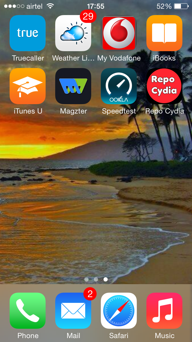

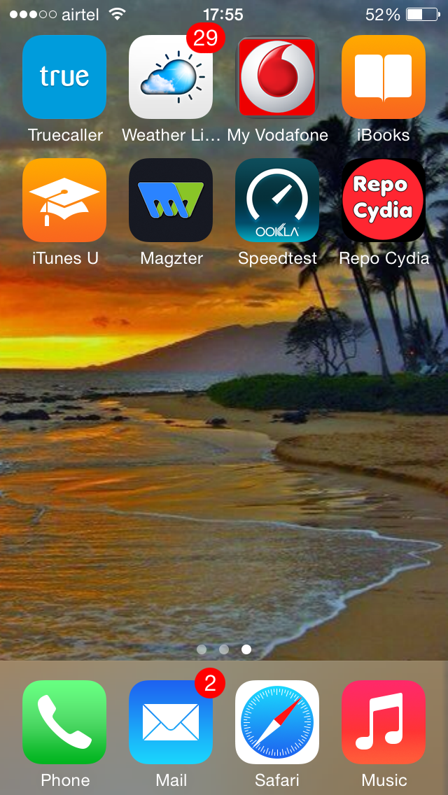

I did a jailbreak on my iphone 5 last year and dint like it much so i did a normal restore from the itunes and it was working fine, i had to restart my phone someday and thn I saw a Repo Cydia red color icon app there in my phone and its been around 6-7 months I'm still facing some issues, is there any solution to it.
I don't have tht previous data which I restored now it i completely erase my phone and restore the data i still get that app back in my phone, and i feel that is creating some problems in my phone.
I'm attaching a screen shot of the app icon, do let me know if this can be resolved.
You are getting it back because you are restoring from your backup. You need to start as new after restoring to completely remove everything related to jailbreak
