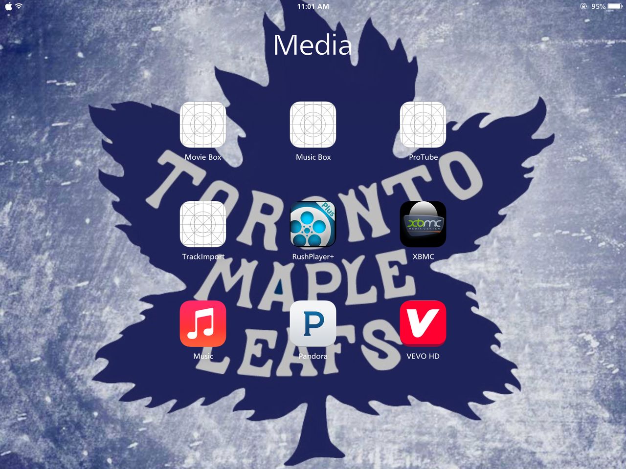

Some apps I got from Cydia include Movie Box, Music Box, MxTube, ProTube TrackImport. Sometimes they will all just randomly stop working/crash. I press on them to open it and it just comes back to the home screen. When I respring my device all the apps I mentioned above are gone from my home screen. I search for it on spotlight and they are not there. I have to go into Cydia, go to my installed section and press reinstall. They funny thing is I just press reinstall on one of them, lets say ProTube, and when I go to the home screen they are all back again. Does always reinstalling take up the space, because Movie Box is 8MB. Is there a way to fix this issue. I'm on iPad 4 7.0.4

ProTube was the first thing I installed when I jailbroke my iPad yesterday. On the Cydia page it says ProTube is compatible with iOS 7. These crashes were happening even when ProTube was the only thing I had installed from Cydia.

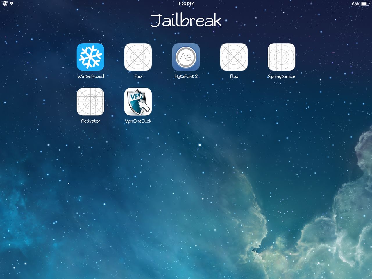

Also the apps sometimes turn into this icon in the picture below when they stop working and keep crashing. It turns into like a white blueprint/target symbol.

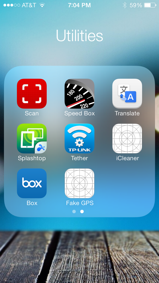

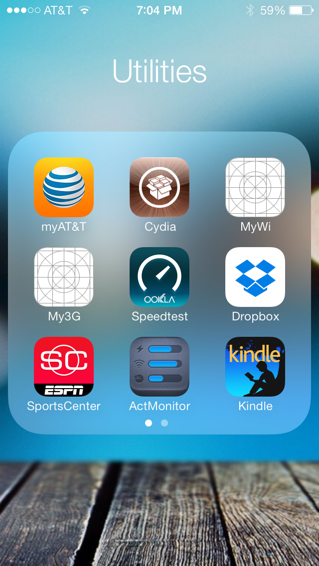

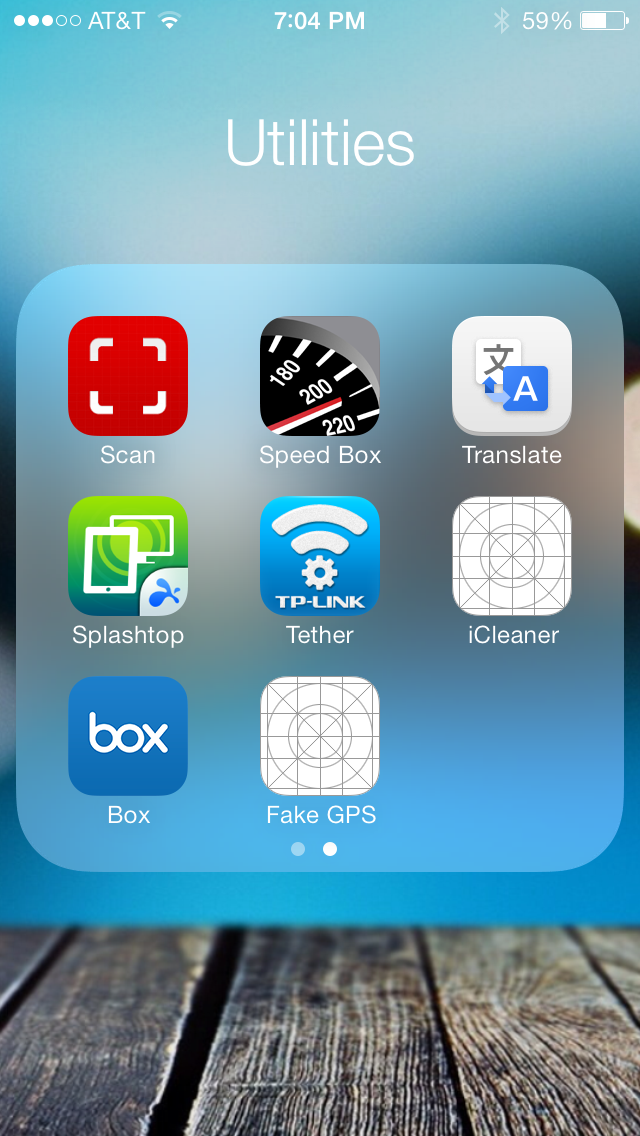

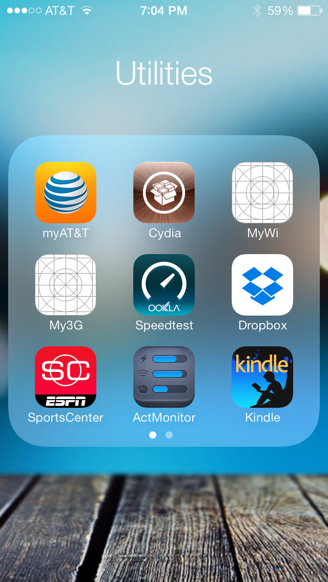

Is this happening to anyone else????? My cydia apps always turn into these as the app icons and they always crash on startup and I have to respiring to get them to work.
I'm having this EXACT same problem. Was just getting ready to make a new post about it:
