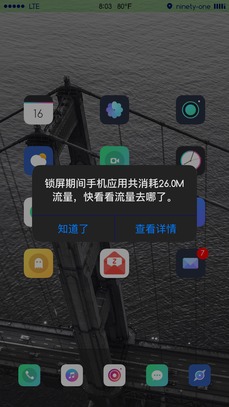

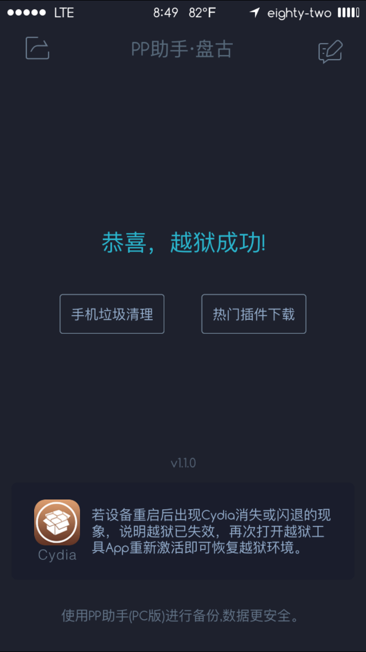

I did the safari mobile method about a 2weeks ago, phone ran smooth no problems. Fast forward to a couple days ago and now my Cydia keeps crashing. Jailbreak and tweaks work fine but whenever I try opening Cydia it'll just crash. Every once in a while I'll get a pangu notification that I don't understand. I've tried respringing as well as rebooting and no luck.

Run the PP App again....it's a semi tethered jailbreak. After every reboot you need to run it again.

I believe I did so.
I'll open the app and get the first screenshot.
I've also completely ran the pp app to re jail break and same thing happens. Tweaks work but Cydia keeps crashing.
