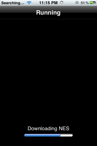

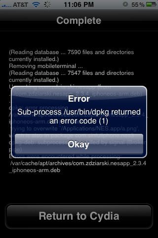

hello i am new to jailbreaking and i jailbroke my iphone 3gs running 3.0.1 firmware with redsnow and i did not install icy only cydia
so here is my problem
before i could download things fine but after i installed nes i got an error and it didnt work so i removed it

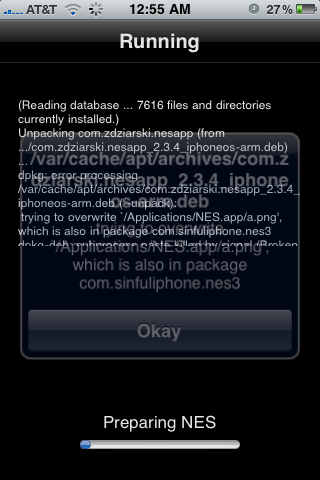

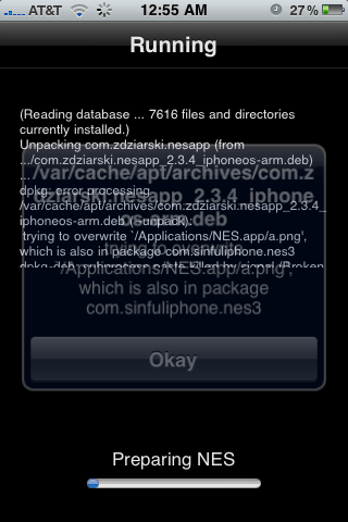

but it looks like it keeps trying to download when i download anything else

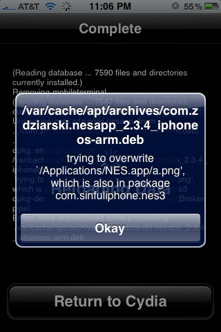

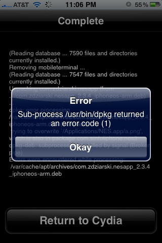

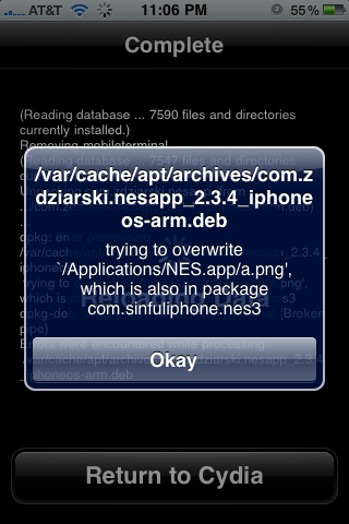

i also downloaded nes 3 from the sinful iphone source i keep on getting this error

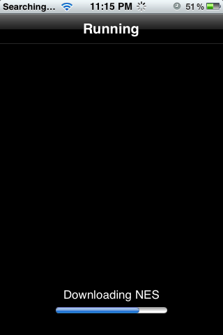

as you can see in the third and fourth picture it tries to download and prepare nes even though i was trying to download some other theme
please help me fix this
also when i go to the nes page it says que but i try to cancel que and it doesnt let me

Cydia Fix
I know this is a late response and the original author of the topic has probably re-jailbroken to fix Cydia but if not here's the fix.
1.Install Icy & iFile.
2.Remove SinfuliPhone repository from Cydia.
3.Run iFile and browse to /var/cache/apt and delete everything (not "archives").
4.Run Icy and uninstall NES.
5.Respring
6.Run Cydia and install the NES package that Cydia wont clear.
7.Uninstall using Crydelete or Cydia and finish what you were trying to do.
If you're still receiving errors then it could be that you need to remove the BigBoss repository and that can't be done which in that case you'll have to re-jailbreak.

I had the same exact problem and I went as far as to uninstalling and reinstalling Cydia from the ground up without a solution. I also tried using terminal command su, alpine, dpkg -r -force *.deb and all I got was a more descriptive reason as to why the system couldn't do an override. If there is a fix out there for this, this is the solution and no other.
