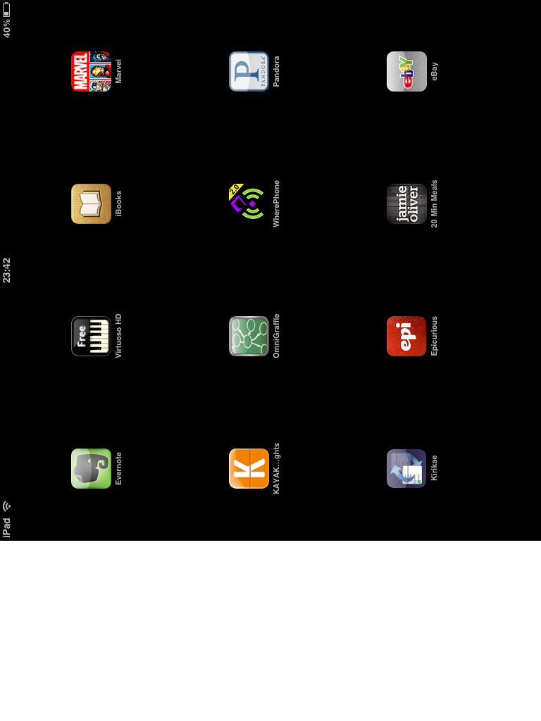

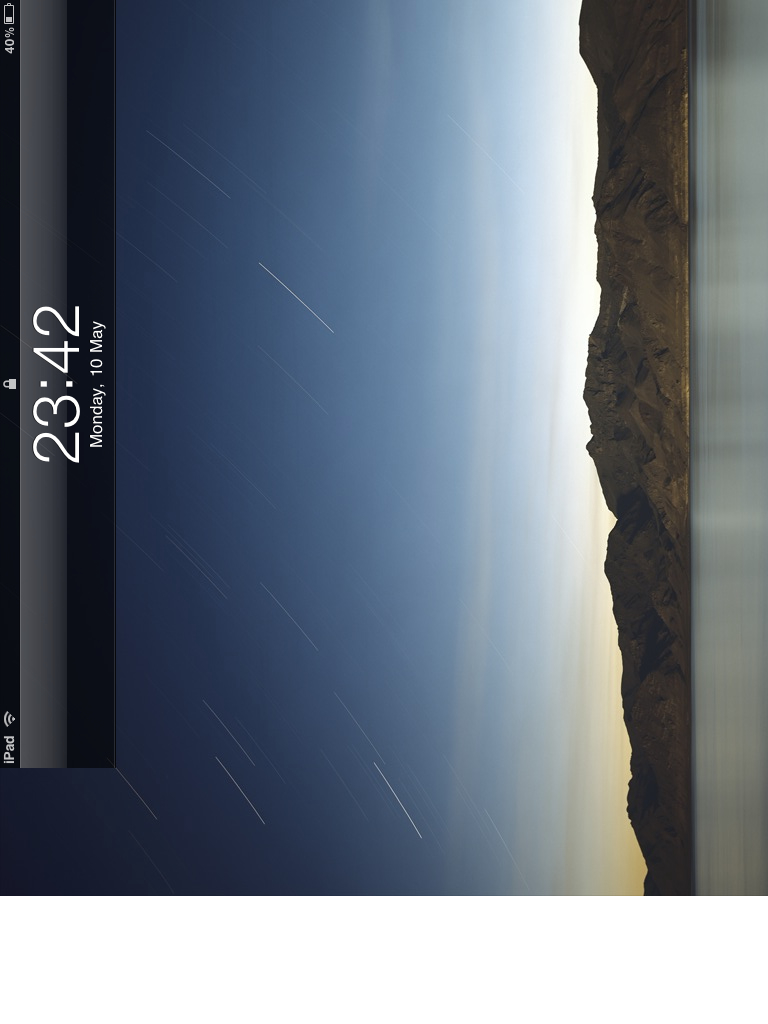

Happened to me now.
Could not respring from BossPrefs because the respring option could not be reached due to resize.
Even the screen lock orientation button changed into 'silent' button as in the iPhone 😱
Finally found how to fix this.. Changed the Lock screen/Home screen wallpaper.
After this I also installed Sbsettings just in case.
Took some screen captures also
*Icons had turned small btw

Happened to me now.
