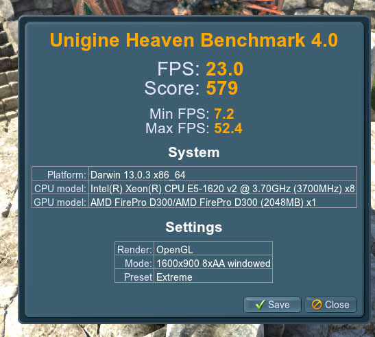

So we've got scores for the D300 and D500 cards for the Heaven Benchmark, extreme preset. We're still short on the D700's score. Could someone with D700 GPU's run this benchmark. Yes, the CPU's have been different, this is by no means a scientific test, just some nerding-out. THANKS! A link to the benchmark is below...
http://unigine.com/products/heaven/download/

Indeed, would be nice if someone here know someone with a review unit, like anand 😉
I expect them to score around 30FPS mark
why does 12 core (4 extra cores) with D500 (instead of D300 @ 8 cores) score less?
That makes little sense doesn't it? Assuming both Turbo Boost during the test.
yeah this was expected. We were all speculating that the d500 were gonna perform worse than the d300 in games.
Still makes no sense, unless its the CPU in the 12 core.

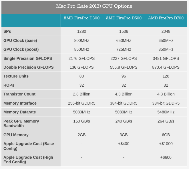

D500 Specs
1525 Stream Processors (texture mapping units/unified shaders)
384-bit memory bus width
240 GB/s memory bandwidth
3 GB Vram GDDR5
D300 Specs
1280 Stream Processors (texture mapping units/unified shaders)
256-bit memory bus width
160 GB/s memory bandwidth
2 GB Vram GDDR5
I wonder. These GPUs are said to be optimized for OpenGL but score that low?
They're for OpenCL, there's a difference. AMD is leagues ahead of NVIDIA in OpenCL, but NVIDIA is better at OpenGL.
AMD's OpenGL drivers have always been playing catch up, so we can only hope Apple is going to get them to sort that out.
Thanks for clarifying this!

One of threads in the forum had us debating this. I think it was the one where they showed the turbo and electric draw of the graphics card. Basically the d500 is a severely underclocked tahti (7970hd core). And the d300 is a picturn (*not sure how to spell it) (7870 core), it is also more overclocked and has a higher turbo boost than the d500.
Ah ok, thanks. Will have a search on the forums. It is still odd to be beaten when somebody upgraded the GPU from the stock model unless the card excels elsewhere, otherwise it needs fixing. I guess Apple could software mod the clock rate. Lots of D500 owners are going to be shouting at Apple for misleading them if it holds true in other tests.

Looking at the 7970 vs 7870 which seems reasonable to me, it seems the D700 should get around 30% better frame rates. Very much dependent on the game.
If that's worth 1000$ dollars to you. I think i rather turn some settings down one notch. I mostly play blizzard games anyway, D300 should handle those just fine i think.

Ok, what is it in these specs that is making the D500 such a dog for regular tasks?
Is it just the lower clock speeds? If so, is the D700 going to be equally as bad for normal loads?
Or is it the lower clock combined with the lower percision ratings, where the D700 rates much better?
