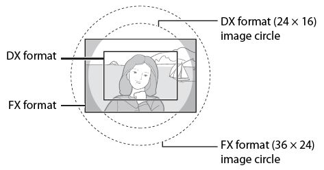

Other than the 50mm, I believe all the lenses you list are DX lenses. I love my D700, but the D300s is a worthy camera in it's own right - most of the advantages of the D700 (e.g. 51 point autofocus, mirror lockup, almost-as-good high ISO performance), plus it's got a DX sensor (so all your existing lenses will work) and will save you a good chunk o' change. B&H has the D300s body for $1500 right now.
The OP can select DX mode on his new D700, so his DX lenses certainly can be used with that FX body. There won't be degradation of the images because of that, he'll still have all the IQ advantages of the D700, just not the FX picture angle. He'll get better images from his DX lens/D700 combination than with his DX lens/D90 combo. His IQ will improve, just not using the FX sensor to its maximum advantage.

This is not true, maybe you shoot Canon and are used to the thought of non-compatibility between formats but DX lenses will mount and work just fine on FX Nikon cameras. The only drawback is the loss of about 50% of the resolution. Put a 17-55 f/2.8 on a D700 and you have a fantastic combo which has the resolution of a D40 (which many many people find more than enough), and the high ISO performance of the D3.
Sure it'd be nicer to have the ability to buy all FX formatted lenses with the D700, but if the budget doesn't allow it, then it's not the same problem that it is with Canon cameras, the lenses do port across formats just fine.

If the OP gets a D700 and uses his current glass, he has degraded to a 5MP camera. Now if all he is going to do is to post snapshots on Flickr then yeah maybe that's okay (however at that point there is a serious argument as to whether the improved IQ of a D700 would even be visible) however as a student of the arts as he says, there is a good chance he's going to be making fine-art level prints, where 5MP isn't going to cut it. The D90 would likely net a better image (i.e. slightly noisier but much sharper).
I make no judgment about whether such a move makes financial sense. Only the OP can decide whether the IQ improvement is worth the expense.
That crops the image from 12 MP to 5 MP.
