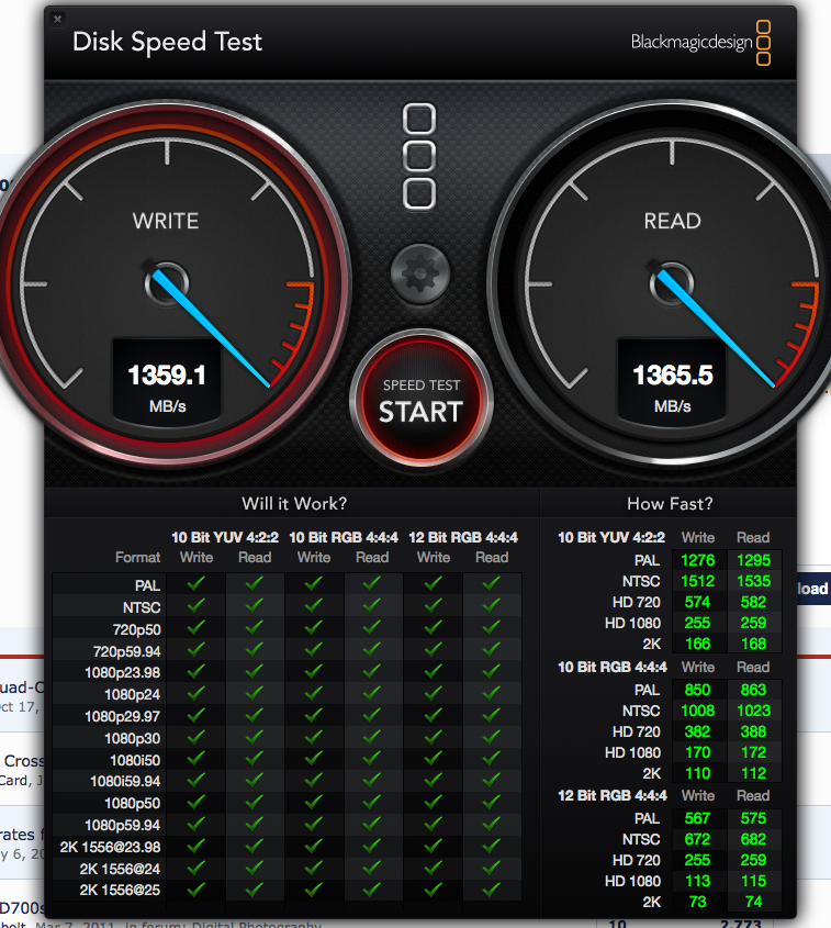

As far as the SSD goes in the nMP...I received my build to order nMP last week with a 1 TB SSD. I have seen a lot of people post videos on YouTube running the BlackMagic speed test and getting around 975 mb/s. When I run BlackMagic on mine I'm getting in the ballpark of 1350-1375 mb/s. So, maybe Apple has changed something in the current nMP? I can post a video of the test if people would like. I believe the SSDs in the new MacBook Pros are still faster, however.
As much as I used to hate on the nMP design compared to the traditional cMP, I'm really starting to see the appeal. I literally take it with me everywhere right now. I can't do that with my old one, which is, and has always been, relegated to my main office. Also with my travel schedule the ability to pack this much power into a small form factor that I can take with me is great. So what I'm trying to say is that I see both sides of the coin - nothing replaces the traditional desktop style computer...but having something small like this has it's perks too. It's just too bad we can't have the option for both.
Interesting, just have a look at the part number in system profiler.
The SSUAX drives had an "F" in there, the SSUBX have a "G"
(right after 1024 as I recall)

It appears to still be the older design: EDIT: Misread - it's the newer design.
APPLE SSD SM1024G
I am getting good speeds, however.
APPLE SSD SM1024G
Actually, MacVidCards' information suggests this is one of the new, faster models:
The SSUAX drives had an "F" in there, the SSUBX have a "G" (right after 1024 as I recall)
That would explain your 50% boost over the YouTube Blackmagic benches.
Good stuff!
I suppose your lucky machine was assembled when you CTO'd last week and they grabbed the latest parts off the shelf.
Good stuff!
I believe you are right; I misread MVC's post.
I would have been happy either way, but it's a pleasant surprise!
