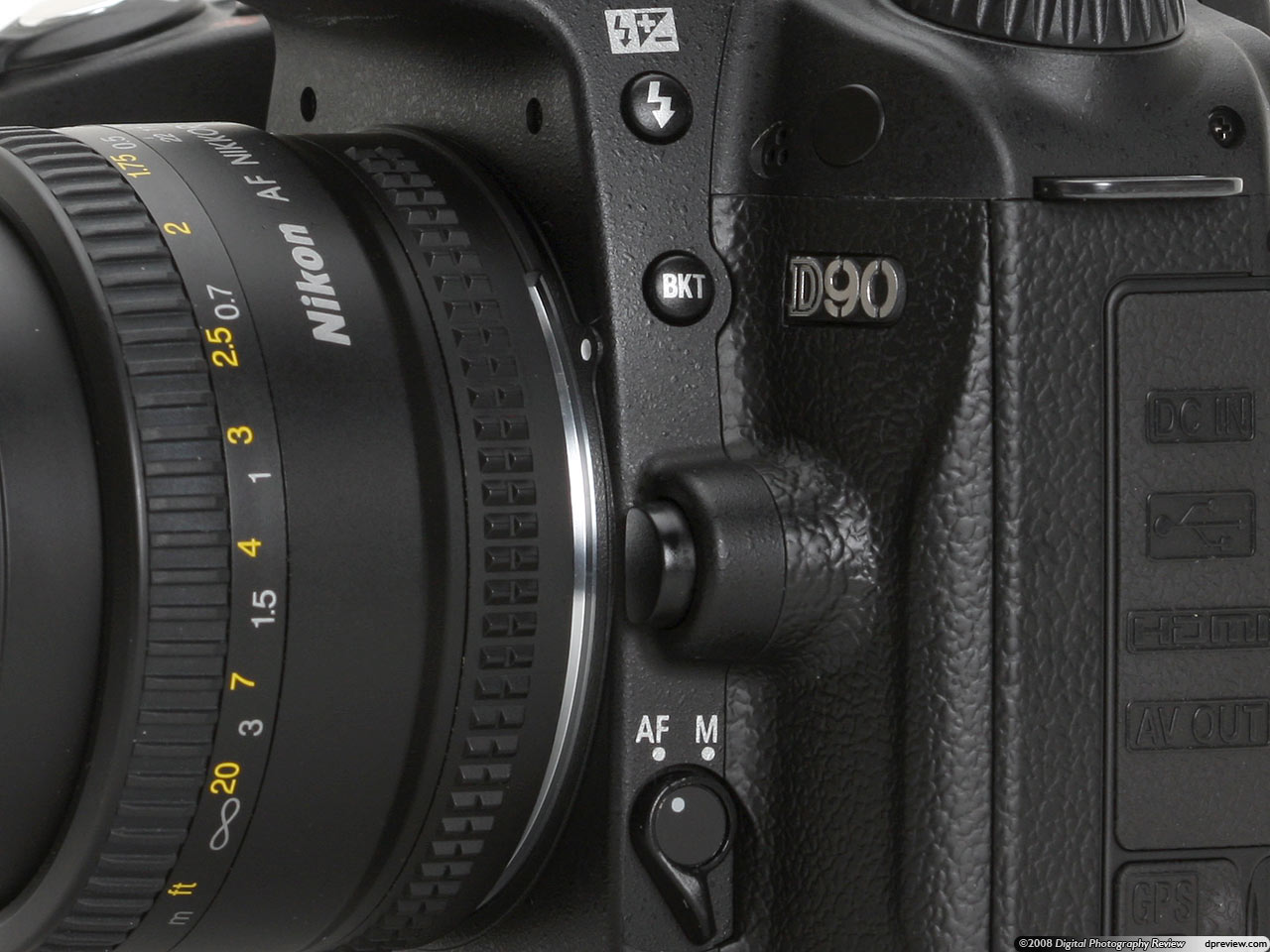

Do you have the AF/M switch (auto focus / manual focus) turned to MF (manual focus)?
The switch is turned onto AF. Nothing happens... It does not focus automatically.

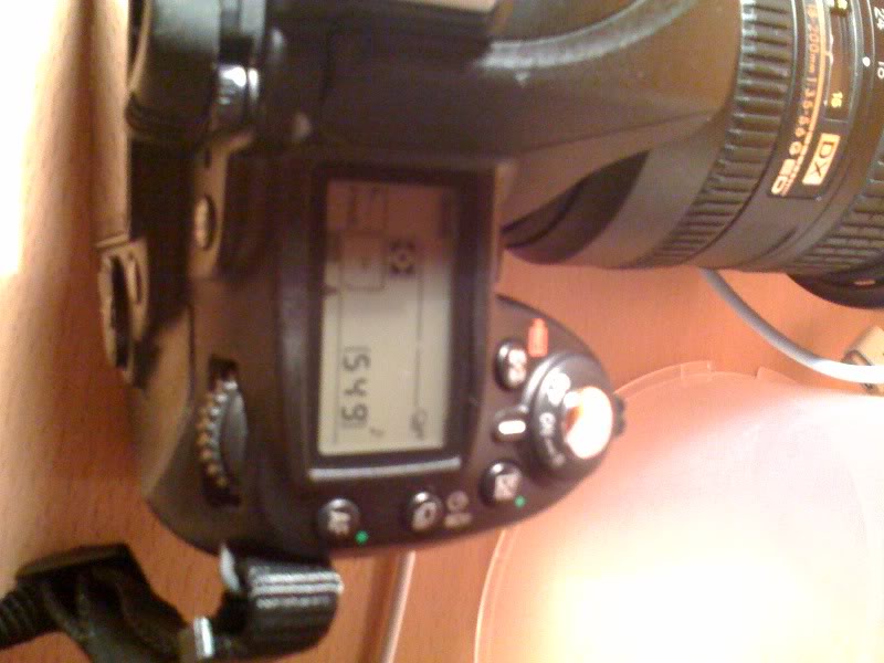

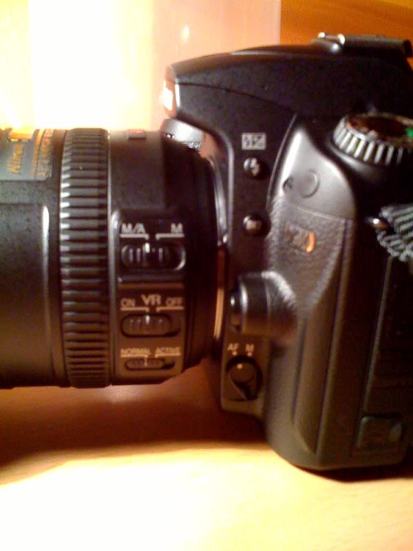

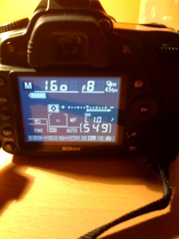

Sorry for the low quality pictures quickly taken with my iPhone with bad lighting but as you can see everything seems to be correct and still no dice.
See the MF near the center of the LCD display? That does not show up on the control panel display on the top of the camera. Nor can I change it here or when I press the menu button and do it through there.
What to do? Go and exchange it for a new one at the store tomorrow? I'm hoping there is some hidden feature on the camera that enables it and just makes me look like a rookie instead of going all the way back and returning the camera.
