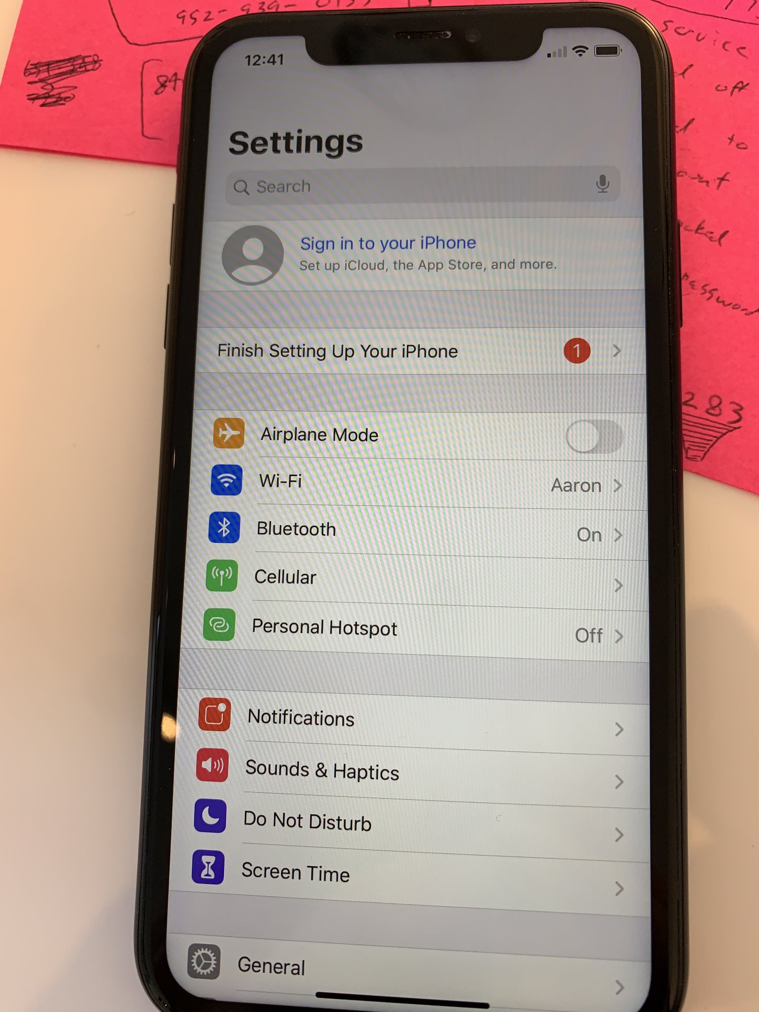

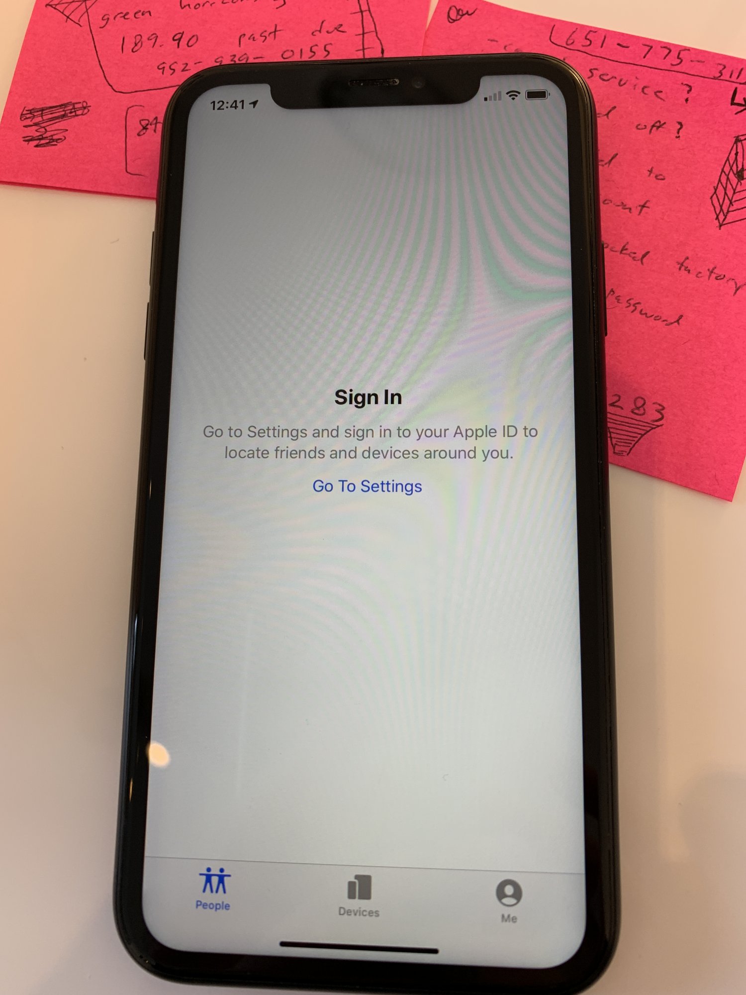

Restore completed to the initial Hello screen, I walked through it and went to Settings and it says "Sign in to your iPhone" where you are normally signed in to iCloud.
I also opened the Find My app and it says I have to go to settings and sign in to my Apple ID.
Am I good then? Ready to sell?

this is what i see in settings and when i open the find my app:
i did not see any type of activation lock message, i was able to reactivate the phone on his account with his normal sim card as usual, but i dont think id expect to see an activation lock problem anyway if its just being reactivated with his account vs someone trying it with a new account? Maybe the next person would have a problem?

You're fine. If Activation Lock was present, you would not have been able to set up the phone at all following the erasure. You'd have seen an Activation Lock screen that demanded the password for your dad's Apple ID.
