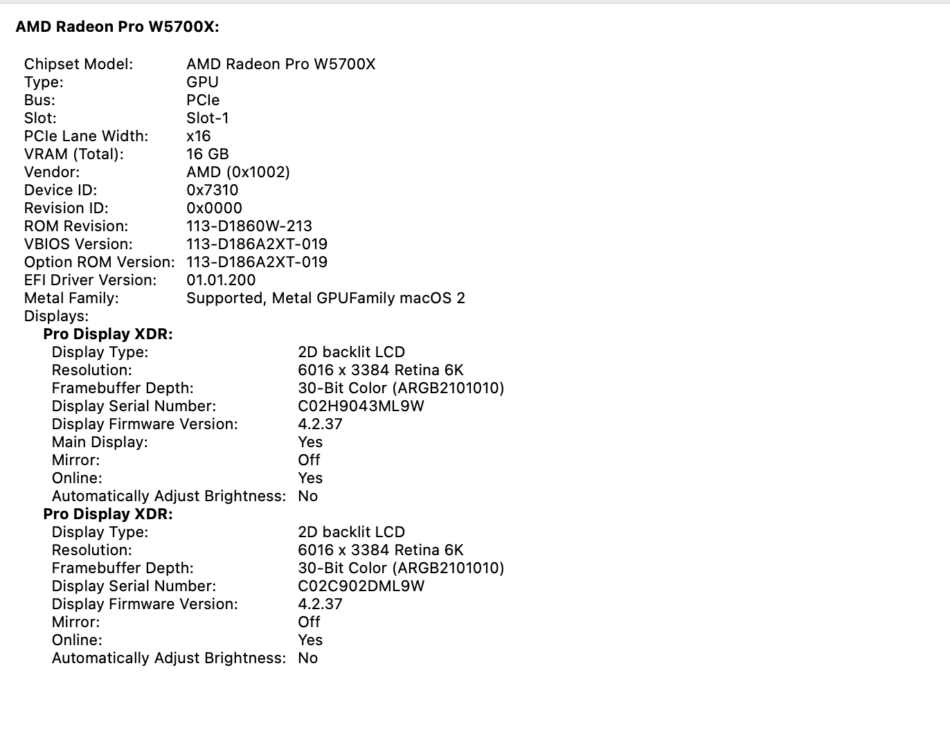

The CalDigit hub worked. Thank you! Am I correct in reading the attached screenshot that both displays are still displaying in 6k?
macOS only shows the framebuffer resolution and framebuffer pixel depth.
You need a different method to show the output resolution and output pixel depth.

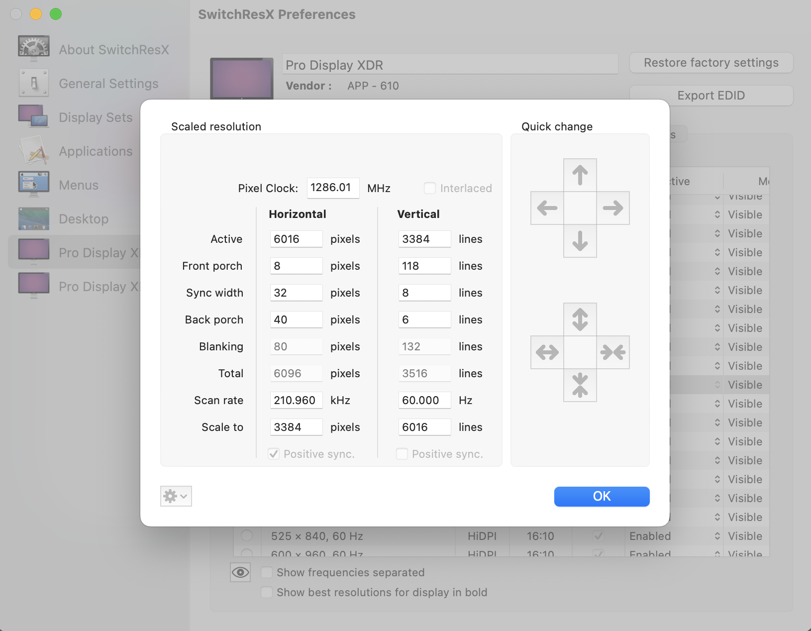

You can use SwitchResX, double click the current resolution in the Current Resolutions tab, and see the pixel clock and active pixels in the timing info.
You can use the AGDCDiagnose command to show the output resolution, the output pixel and color info (including DSC and chroma subsampling info), and connection link rate and lanes and other DisplayPort info.

Thanks. Does the attached screenshot I took from SwitchResX indicate they're operating in 6k?

Yes, if that was the currently selected resolution.
Pixel clock is 1286 MHz and active pixels is 6016x3384 which are expected for this display.
Scale pixels is 3384x6016 which probably means you are rotating the frame buffer 90° or 270°.
If you were scaling 6K to 4K output (which would happen if you connected the display to a DisplayPort output that is not Thunderbolt and does not support DSC or if you added a custom 4K timing and set 4K as the Scaled resolutions base), you would see pixel clock 533 MHz and 3384x2160 active pixels and "Scale to" set to 6016x3384.
SwitchResX might have a 4K timing already defined from the XDR EDID. See if there is a 3384x2160 mode that is not scaled (or use "Show best resolutions for display in bold"). The "Scaled resolutions base" setting is in the Display Information tab.
