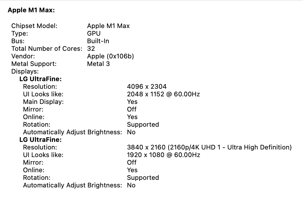

I have the same configuration with a MBP 16M1, 4K directly connected to the MBP, and 5K daisy chain to the 4K monitor, the Ultrafine 4K runs at 1920x1080 and the 5K runs at 2048x1152, they both look fine, I am not sure if that's 4K or 5K resolution.
LG UltraFine 5K can't do 5K60 from a Thunderbolt port that has another display connected to it.
macOS only shows the frame buffer resolution of the displays. It does not show the output resolution that is being sent to the display. You need to use a utility like SwitchResX to view the timing info of the currently selected display resolution. Double-click the currently selected display resolution in the Current Resolutions tab of SwitchResX. It will show the pixel clock and active pixels. For 5K it should show pixel clock > 900 MHz and active pixels 5120x2880.
If you only want to use 2048x1152 then I suppose it doesn't matter since there's little difference between having the display scale 4096 x 2304 to 5120 x 2880 (what you are seeing now) vs having the GPU scale 4096 x 2304 to 5120 x 2880 and in fact you might be getting slightly better performance by not having the GPU do the scaling.
However, if you want to use "Looks like 2560 x 1440", then you'll definitely want to connect the LG UltraFine 5K to a separate Thunderbolt port because otherwise you'll have 5120 x 2880 being scaled down to 4096 x 2304 by the GPU and scaled up to 5120 x 2880 by the display.
