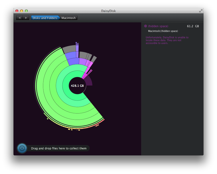

How can I clear this up? I need the space!
Any idea what it could be? If it was *just* local TM "snapshots," shouldn't DaisyDisk be able to tell that much?
Per the DaisyDisk website I did run Disk Utility and perform a "Repair Permissions" on the boot volume, but it still shows the hidden space...
I also turned TM off, but I suppose I didn't really expect that to do anything : /

So I can understand this. You have a 500 GB hard drive.
If I am reading your picture right there is 343 GB space for Users. Is your hard drive full already? 😕
There is 60 Gb of space hidden. Could that be reserved for programs or system use?

I back up all the time, so that is not the issue (I think). Also local TM backups should delete themselves as space is needed, and I do find them a particularly useful feature. Moreover, local TM backups show up as "/Mobilebackups" or something to that effect. You can see that they are shown alongside the "hidden space" nonsense. SO that makes me think it has nothing to do with TM. Could be wrong though...

What are you confused about? My HD is at 420 something, 60 of which is this hidden space. It is clearly not full. My post was not about whether my HD was full or not. Obviously, if it was full the HD would be at 500.
I really don't know what it is. That's why I am asking if any of the smart people here know what it could be.
DaisyDisk shows all the other programs and things constituting "system use," as you put it, so I am just not really sure what the "hidden space" is.

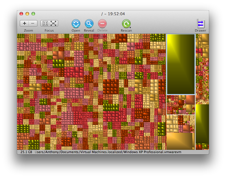

I tried all three programs, and none of them even showed me that the ~60 GB of "hidden space" exists, so that's a bummer.
Also downloaded WhatSize, and it was the same story as all the other programs.
