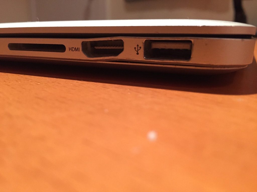

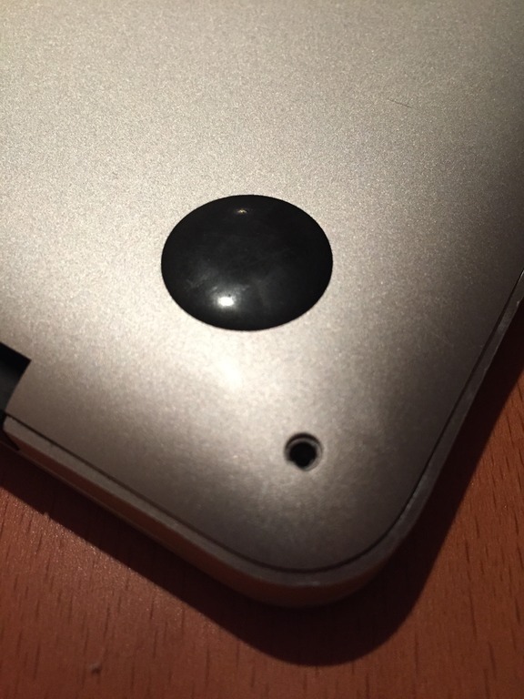

My retina macbook pro (15" 2012) fell off my bed and the chassis became dented on the right side. Fortunately it is working fine and the screen was closed so that was not damaged (as far as i can tell). In addition I also discovered that the screw on the bottom of the right side is missing, and the screw directly to the left of it is in place but appears not to be actually holding the bottom plate in place.
Here is the damage.
I'm have apple care 3 year warranty but I assume this would not be covered, so is there anything I can do to fix the damage (and is it even worth worrying about)? And where can I get a new screw?

Unfortunately replacing the bottom chassi would involve a complete rebuild motherboard and everything else.. you could however check the holding tabs of the screws by removing the bottom panel and see if you can bend the tabs enough to make them align with the screws if the tabs are not stripped.

Does anything rattle or sound loose? I would guess that if one screw is missing and another appears not to be retaining anything the fittings that the screws attach to have broken off the motherboard.

Since it seems that replacement would be very expensive, I have tried to fix the damage on my own. Using a little physical force (and clamps), I was able to somewhat counter some of the dent and bend the chassis back into it's original shape. It's not perfect, but it looks a lot better and is enough where I feel that replacement is not really necessary, and I'm not going to do any more work on it as I feel like it could potentially cause more harm than good.
The remaining issue is the screws. Since the two rightmost screws either are missing or not actually holding the bottom plate to the rest of the computer, there is a very small gap between the two plates when the computer is not on something.
The second rightmost screw is still there, but it seems like the part of the bottom board that the screw holds down it is missing, so the screw doesn't seem to do anything. Would there be any way to fix this except replacing the bottom plate?
If I can't fix that screw hole I'm thinking of moving that screw to the rightmost hole that is missing a screw, but I am unsure if the screws are the same size.

I think the screw may have already been loose but I'm not sure. It may have been missing before the fall but I think that is unlikely, however I could not find the missing screw anywhere near where the computer fell.

8 X 3.0 mm screws - 2X 2.3mm screws (two by the hinge center, all the rest are 3.0mm.
The bottom plate is just a drilled plate/cover. The chassi has molded tabs with threaded screw holes. You just need to try and align the screws so that they actually thread into the tabs of the chassi. Since the screws are very short, you may have to find equivalent screws but longer if the warpage will not allow you to screw in the short screws that won't reach the chassi tabs?.

Okay so it sounds like I can't use the screw from the hinge center on the outside since that is only 2.3 m, so where can I get a new 3.0mm screw? The screw set from iFixit is way too expensive and has way too many screws.
Also it's not that the other screw doesn't reach the chassis tabs, the tabs on the bottom plate are missing in that screw hole so there is no way the screw can hold the bottom plate in place.

If the plate is stripped , a makeshift washer? (or a new back cover)
