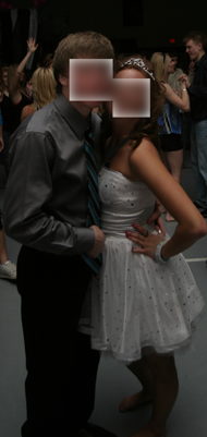

Long story short, I'm roped into shooting a local dance. Purely candids, nothing professional or for profit. This is outside of my arena, however I've done this once for them before. I'm shooting purely with my 10D and my Speedlite, no external flash system. I don't have the best lens, I use the one they typically provide, as they have another photographer (It's sorta my school deal.)
Here's a pic I took at homecoming. And the exif details. Can someone tell me if I'm doing something wrong? I know what I'd look for, but I have not altered any of these pictures before....and they're not expecting much (believe me.) Hence the reason I'm not exactly using my best gear (I'm also involved as a student).
shutter speed: 1/60
f-stop: 3.5
aperture: 3.5
focal length: 20mm (I'm shooting with a 35mm today...I know *cringe*)
That said, any pointers on what I can do to work with what I have?
