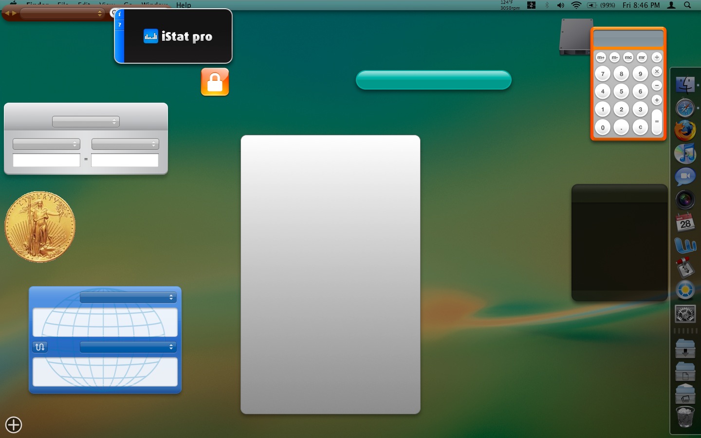

Every time i launch my dashboard, it just goes into a non-loaded dashboard page. There is no activity. Does anybody know how to fix this?
Heres a screenshot.

Are you talking about Dashboard? Your dock is running fine.

My bad, the dashboard. No it's not loading at all. There's no activity what so ever when i launch it. Im positive its not stuck loading.
