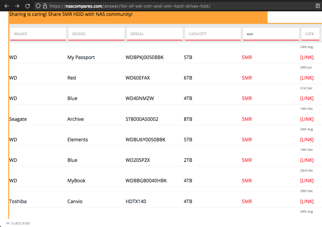

WD Red are for NAS (as I mentioned). Do be careful with these as WD pulled a dirty trick at some point with the disk caching. You can look that up, but basically some WD Reds are slower because WD chintzed out.

With WD Reds one has to watch out - they've moved some of those models to SMR technology:

Yeah, the SMR thing is what I meant with WD Reds. Just couldn't recall the name of it.
General rule of thumb: SMR is a feature to avoid — an engineering blunder on WD’s part, given the extra wear and energy needed to write/move data on the platters. (SMR also appeared on a very limited set of WD Blue HDDs and on at least one WD Black HDD model.)
The above is also a handy tool for verifying which drives across the major manufacturers — WD, Seagate, Toshiba — use SMR. From that table, it appears SMR has appeared most frequently on the Seagate Barracuda line.
