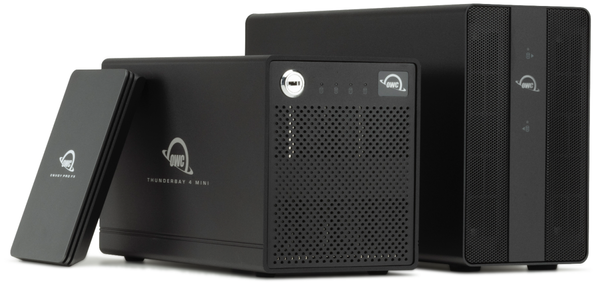

You may also have a look into OWC drives:
