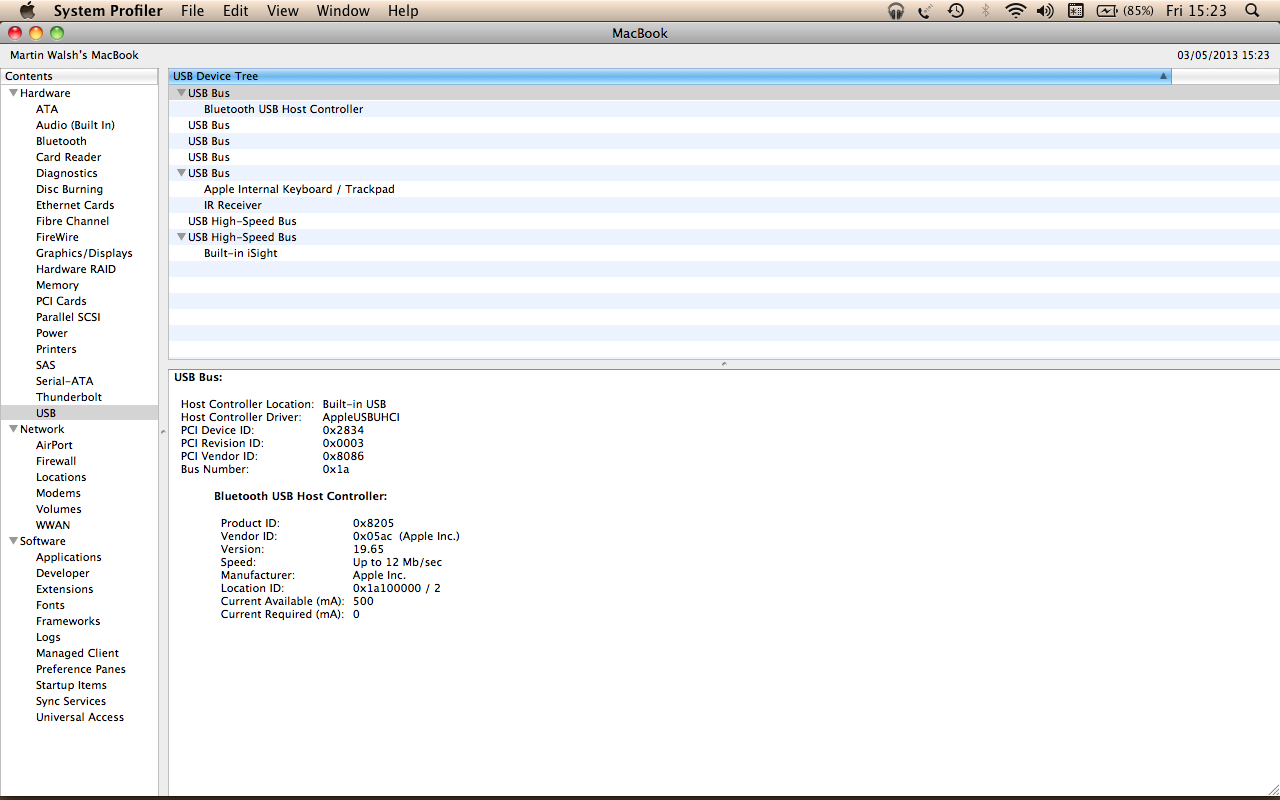

Thanks for the tip, unfortunately it doesn't show up in the System Profiler. I've attached a screen shot for you.
I've got the SSD connected to both USB ports which then go to one USB socket at the port of the SSD through the external case.
Does that make sense? I've tested my other external hard drives, and they're working fine.
I think I'm going grey!
Cheers!

It seems you have one of those USB Y cables, one end with the small connector for the enclosure, and two ends with the big USB plugs. Those Y cables are only needed for power hungry HDDs, thus maybe try the one end which is not bended in one of your USB ports.
And can you link to the enclosure?
