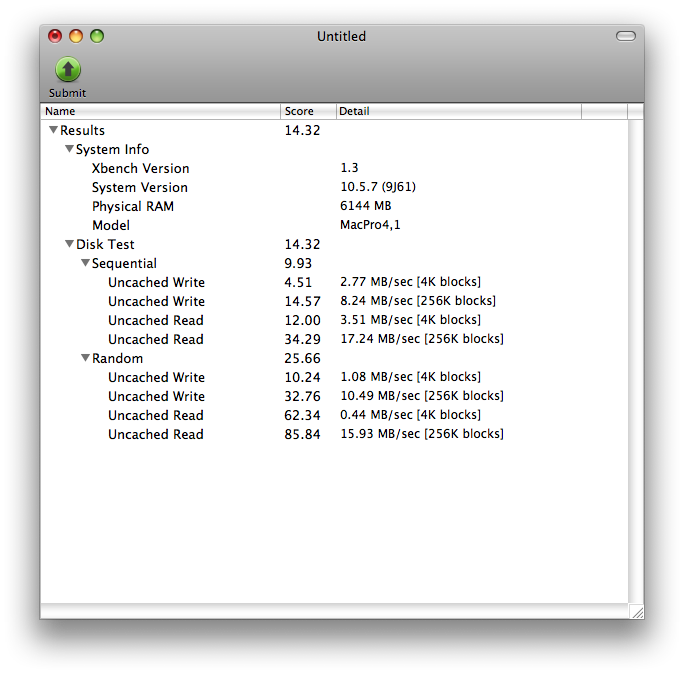

Here's an Xbench of my TC drive from my Mac Pro over GigE... PATHETIC!!!

Is my TC a dud or is this common...
Mine (1TB TC via GigE):
Results 16.48
System Info
Xbench Version 1.3
System Version 10.5.7 (9J61)
Physical RAM 4096 MB
Model MacBook5,1
Disk Test 16.48
Sequential 11.56
Uncached Write 5.37 3.29 MB/sec [4K blocks]
Uncached Write 16.65 9.42 MB/sec [256K blocks]
Uncached Read 13.79 4.04 MB/sec [4K blocks]
Uncached Read 36.89 18.54 MB/sec [256K blocks]
Random 28.67
Uncached Write 12.70 1.34 MB/sec [4K blocks]
Uncached Write 29.08 9.31 MB/sec [256K blocks]
Uncached Read 66.99 0.47 MB/sec [4K blocks]
Uncached Read 86.87 16.12 MB/sec [256K blocks]
Not terribly fast, either, though in practice its reasonably fast. Even copying 1GB worth of data never takes more than two minutes or so (yeah, I know, not too scientific). A 167MB file took ~10 sec. via gigabit ethernet.
