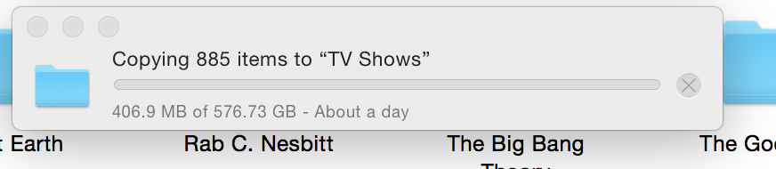

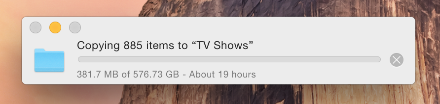

Can anyone explain this?
This is using WiFi
And this is using Ethernet (and yes, the WiFi is off)
Don't mind the estimate. In both, the transfer just started, so the estimate is still very inaccurate. But, it is going to take a while. 500+GB is a lot of data, and ethernet tops out at 125 MB/s theoretical max speed (1GB=1024MB). In practice, it's more like 60-70MB/s. Still way faster than wifi! Thunderbolt would be the fastest, but the cables are expensive. Thunderbolt is about 10x faster than ethernet, theoretically.
