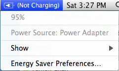

When you have the charger plugged in, the time indicated is not the battery time remaining, but the time until the battery is fully charged. Not charging just means that your battery is almost full, and it's not going to charge it because it's detrimental to the battery to keep charging it if it's >= 95% charged already. I don't think there is anything wrong with your Mac.
There is nothing wrong with this:

Because you started charging it when it was under 95% capacity??
The computer isn't going to constantly top off your battery because some of the power leaks out, that is harmful to the battery.
Ah, there we go. I usually charge the battery until 90% and then let it die until 5% and do it all over again. Thanks for the help.

thank you for this!! That makes complete sense now. I'm a worrier!
