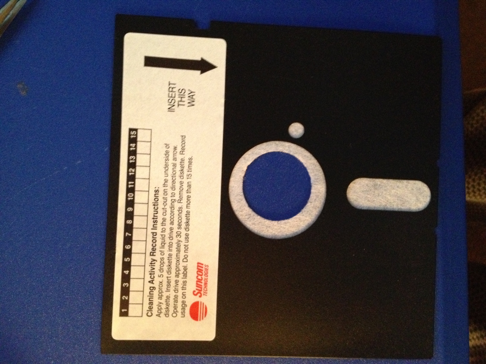

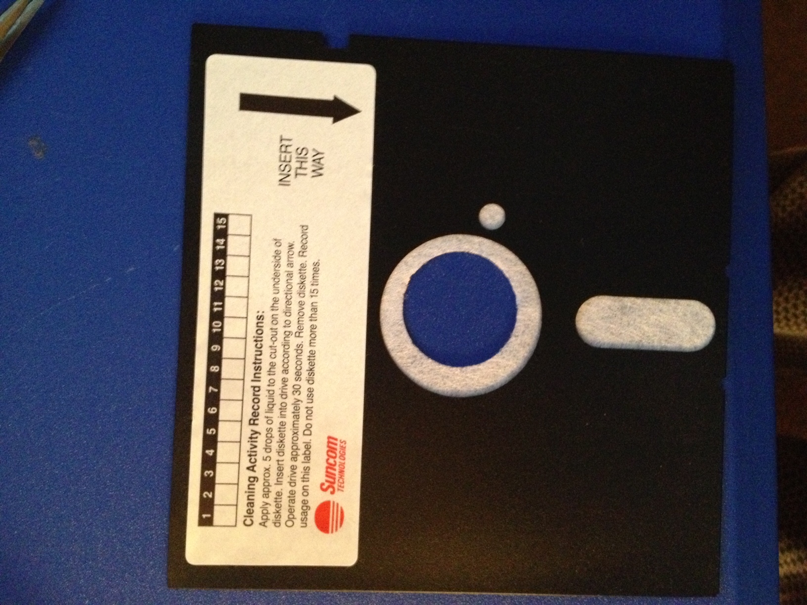

I think that I have a floppy cleaner around here-I recall it being a 3.5" disk with a sort of fiber pad rather than the usual magnetic media and then a bottle of cleaning solution that was dripped onto the pad.
As for what happens, when I put a blank floppy in, I get a message stating that the disk is not readable by the system(everything that I have is factory DOS format) and asking if I want to initialize it or eject it. If I select initialize it, the computer will go through the motions and show me a progress bar, but then when it completes I get an error message that initialization was not successful and am asked again to either initialize or eject. I'll also add that ejection is a bit hit-or-miss.
Does sound like dirty heads, and the disk you describe is exactly the tool. You may need to re-insert it several times since it will only rotate a few times before giving up. The old free TechTool has a floppy exerciser that I used to use to clean heads.

It looks like I'm going to have to break down and buy a drive cleaner. I found the one I remembered having, but unfortunately it's not quite what I need. Close, but no cigar.
