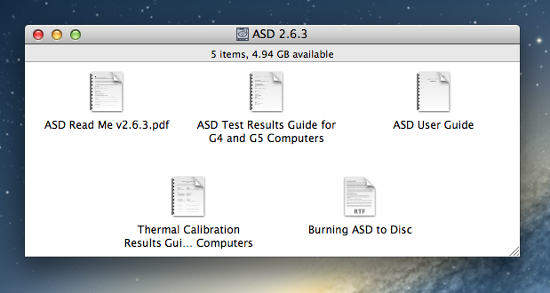

The .dmg is not supposed to be simply placed into the DVD. When it is properly burnt, you will find the 5 PDF files already in the DVD's root directory. Here is what a properly burnt ASD looks like when you open up its root directory.

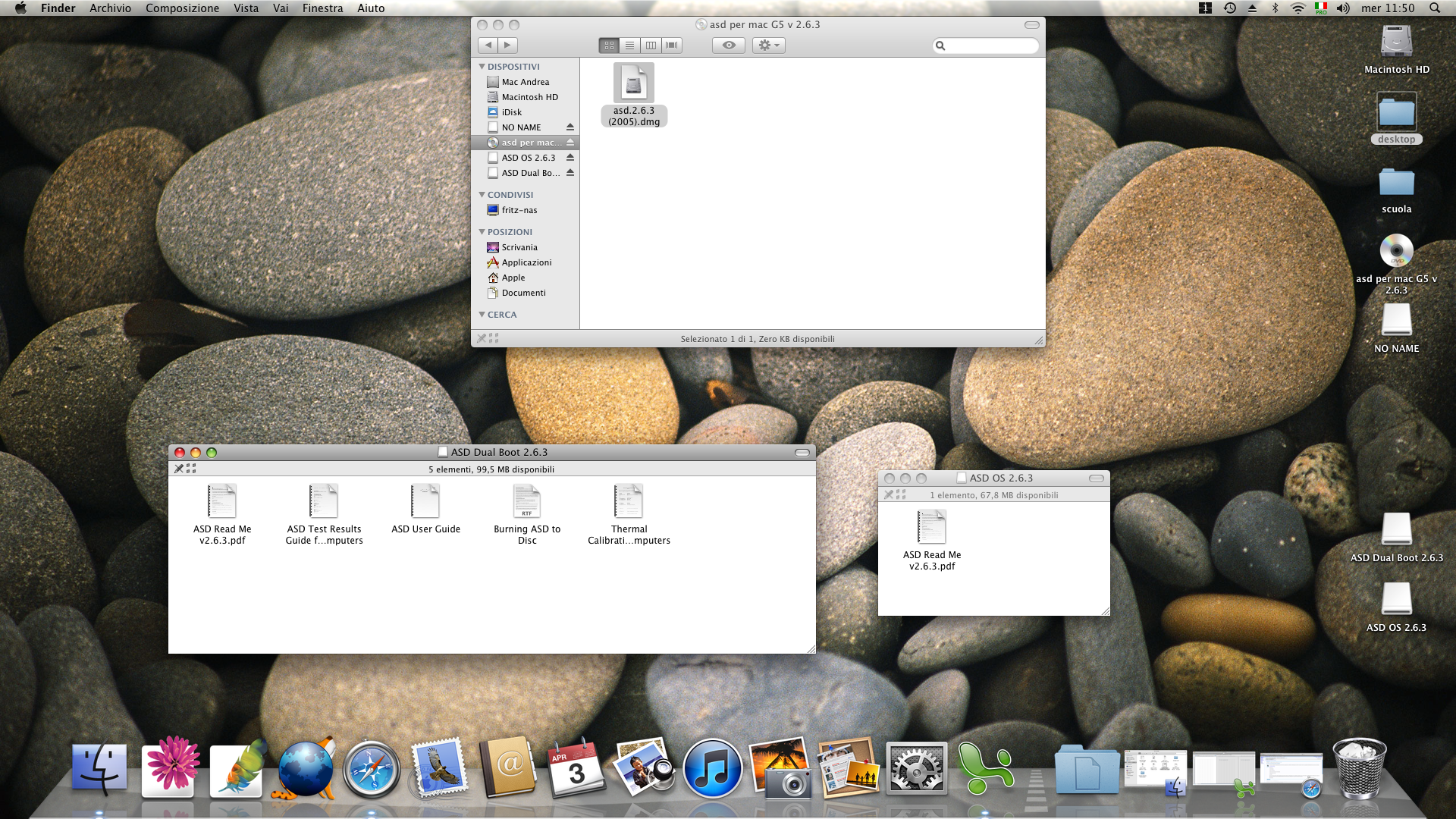

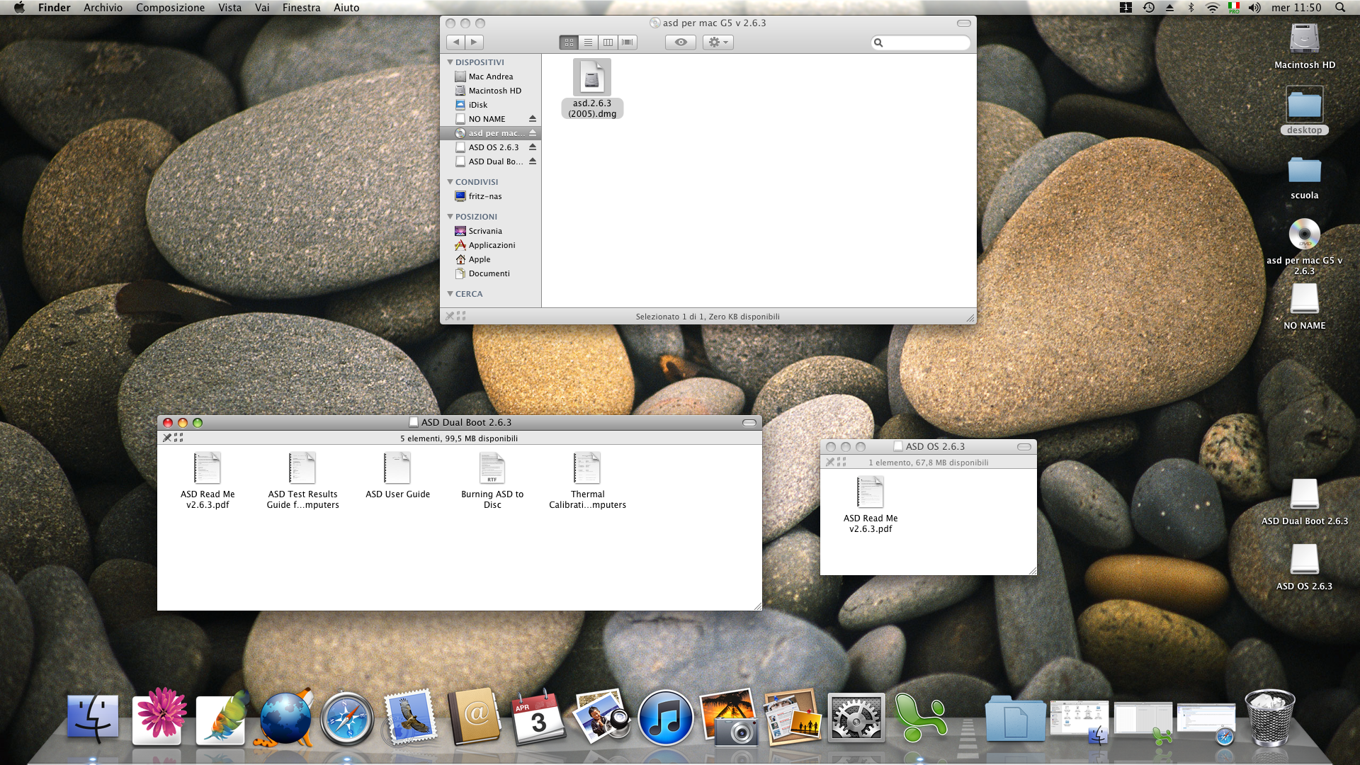

there is a screenshot what happens when i insert the dvd and i double click the first file at the top
is it all right?
is it all right?
Doing that will be totally useless, because you won't be booted into it.
Just burn it (follow the above instructions), restart and hold down the "option" key, and choose "Diagnostics (OF)".
