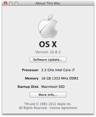

Thought the 2011 MBP runs at 1333Mhz, at least that's what it shows me here (I have 2x8GB Corsair 1600Mhz ram)

Are you on 10.8, 10.7 or 10.6?

i'm on 10.8. I only ever use Crucial, just from my own experiences. I've never had a problem with them.
It'll run at 1600MHz. Just make sure you replace both of your RAM sticks at one time - You need to match your RAM's timings, and having two sticks with different timings can result in everything from significantly degraded performance to system instability.
