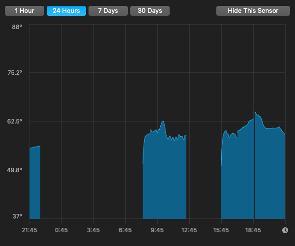

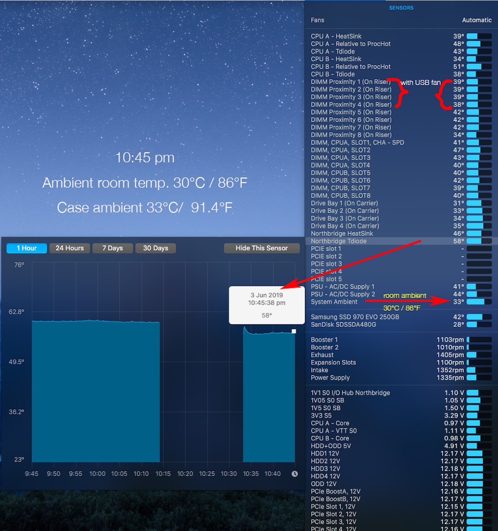

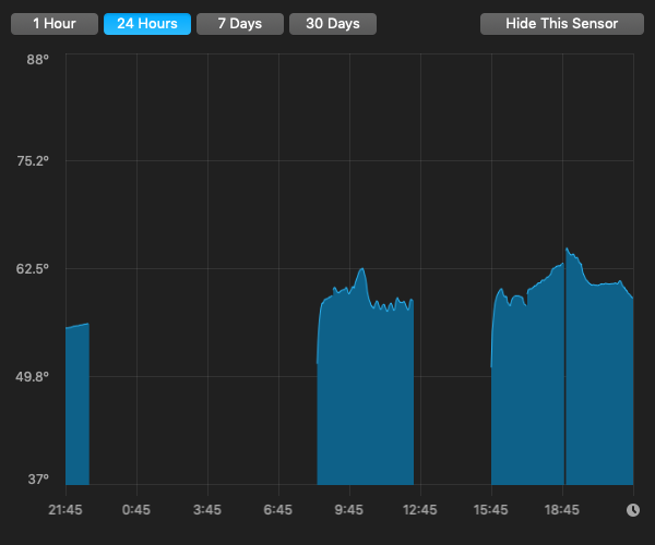

Tonight at 11:30 pm my cMP room's ambient temp is just on still 30°C after a hot day. From now, through June until late August it will get hotter still.
I am now cooling the Northbridge chip + the CPU B & CPU A RAM modules with USB 50mm x 50mm 10mm 16.4 CFM fans and have upped the Intake & Exhaust fans a little.
My intention is mainly focused on the Northbridge chip and I plan to keep the current NB USB fan as a permanent fixture Summer & Winter; the RAM fans will be removed in Autumn & Winter.
Most of today my NB Tdiode temp ranged from 57 ~ 58°C .
I am now totally convinced that a better, more efficient NB heatsink with an attached fan ( see the above size + CFM rating ) can be designed & fitted and am working on creating a test ( copper ) heatsink using a two axis CNC milling machine.
Tonight's iStats Menus

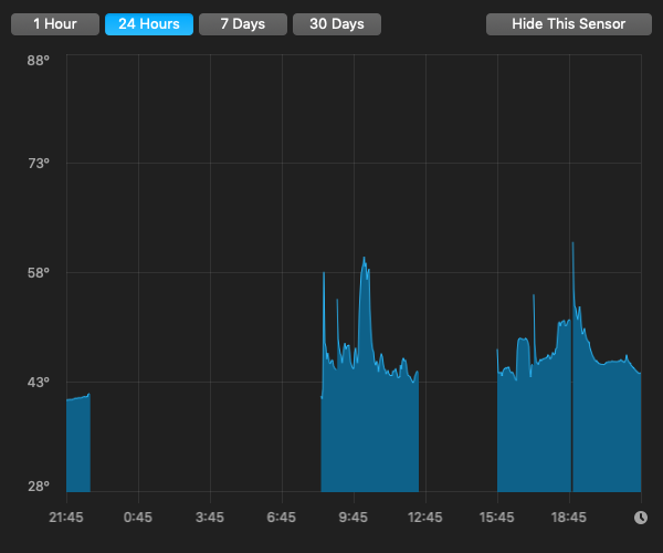

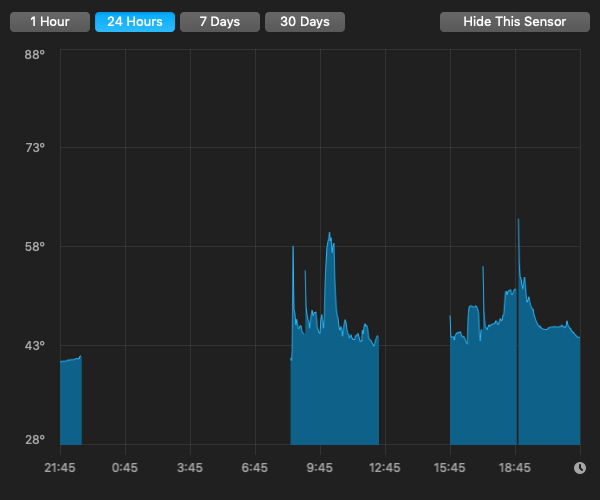

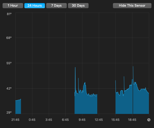

Thanks for the concern for my machine. I an assure you I have compressed air the entire machine.
I believe you are concerned because the pictures I uploaded were during stress tests of my machine via yes and LuxMark. They were running for about 20 minutes where everything normalized. Here are my temperatures with no load. As you can see my machine hoovers between 40-50c. 60c on Northbridge is a bit high compared to your temps but compared to what I was getting before of 80c at idle, I think 60c is better.

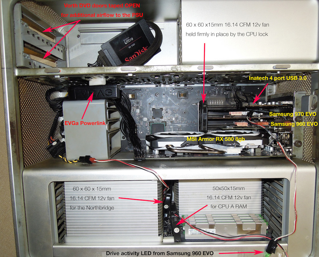

As you can see in the photo below, I have now installed 3 small and slim 16.14CFM 12v fans.
1. Nortbridge fan powered by onboard SATA.
2. PCIe NVMe blades fan powered by PCIe USB 3 card.
3. CPU A RAM fan powered by under-desk 7 port USB 2,0 HUB
Once per summer month I use canned air to thoroughly de-dust everything inside the cMP case and if required, adjust fan positions.
In their current positions, all 3 fans are yielding stable, acceptable temps though in today's pic I had about 4 slightly demanding apps running when I did the iStats Menus screen grab.

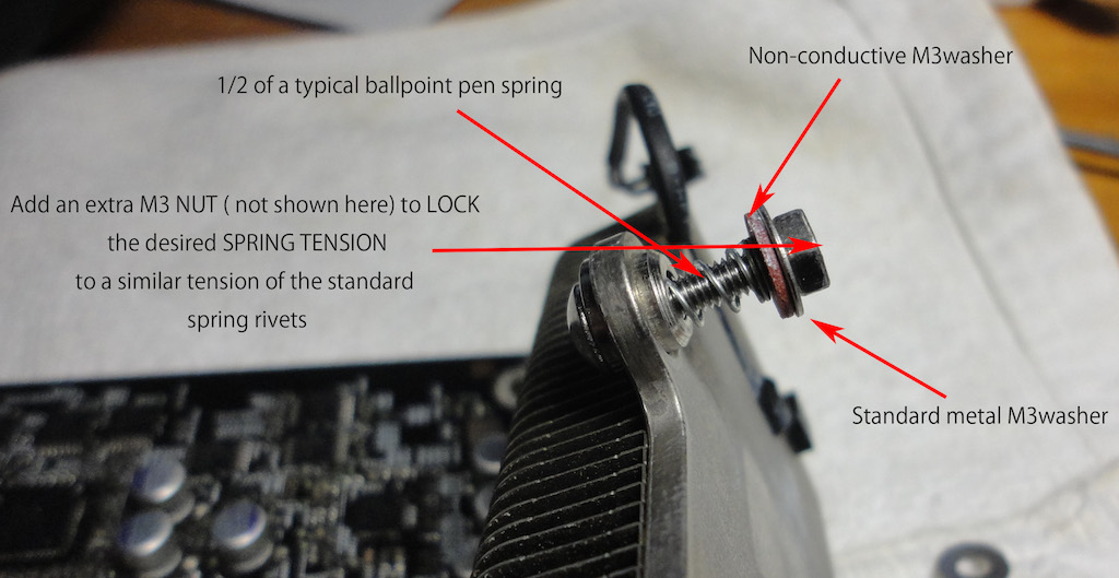

Additionally, my Northbridge heatsink is now attached to the NB chip using the Nut & Bolt technique and with a recent re-application of Artic Silver thermal paste which appears to give a little extra direct heat transfer to the heatsink.
The standard nylon rivets are there to counter heatsink expansion/contraction with NB hi & low loads but in my cMP expansion.contraction is minimised as ( now ) my CPU tray area temps much less now due to the USB fans.
NOTE : A constantly over-temp Northbridge eg: 70 ~80°C cannot be good for humble nylon rivets )

Nut & Bolt Heatsink technique
( Note ; the rivet springs can be used with the bolts )

Currrent stable setup
Notice that I have introduced fans for CPU A's RAM & the two NVMe blades ( the CPU lock bar holds the fan very securely 😀 )
The CPU A RAM fan needs a re-think, perhaps to the rear of the RAM bank & turned 180° to EXTRACT AIR to the main stock exhaust fan.
I will be tidying up the fan cabling this week - I realize that they look a bit messy.
( I used an eraser to hold the EVGs PowerLink securely in place atop the front intake fan. 😀 )

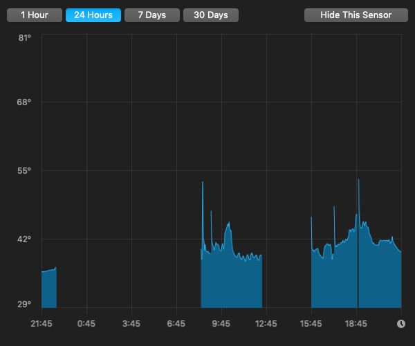

iStats Menus ( Ambient room temp has been 30+° all night. ). fAn speeds a are slightly high but it IS summer here.

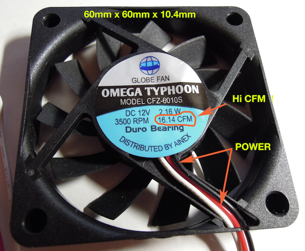

If deciding to install a Northbridge USB powered fan look for 50 x 50 x 10/15mm High CFM ( mine are 16.14 CFM ).
( My first NB fan was something like 10 CFM = not strong enough to make a real difference. )
GOOD EXAMPLE : Omega Typhoon CFZ-6010S ( available only here in Japan I think. )

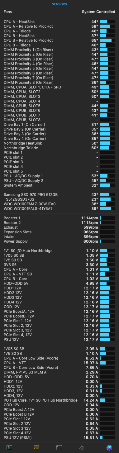

Here’s my actual setup:
Still trying to find out optimal positioning.
The fan is a Noctua NF-A6X25 FLX and I’m using it with one of its “reducers” to lower the fan speed. Interestingly, I’ve found out that, at best, there’s a 2°C difference between the fan at full speed and at reduced speed. With the reducer, the fan is (almost) completely silent.
Northbridge temps are highest when idle, at 60°C, because when CPU temps rise, the other fans go faster. Thus, at full load, the Northbridge is at 50°C due to the surrounding fans.

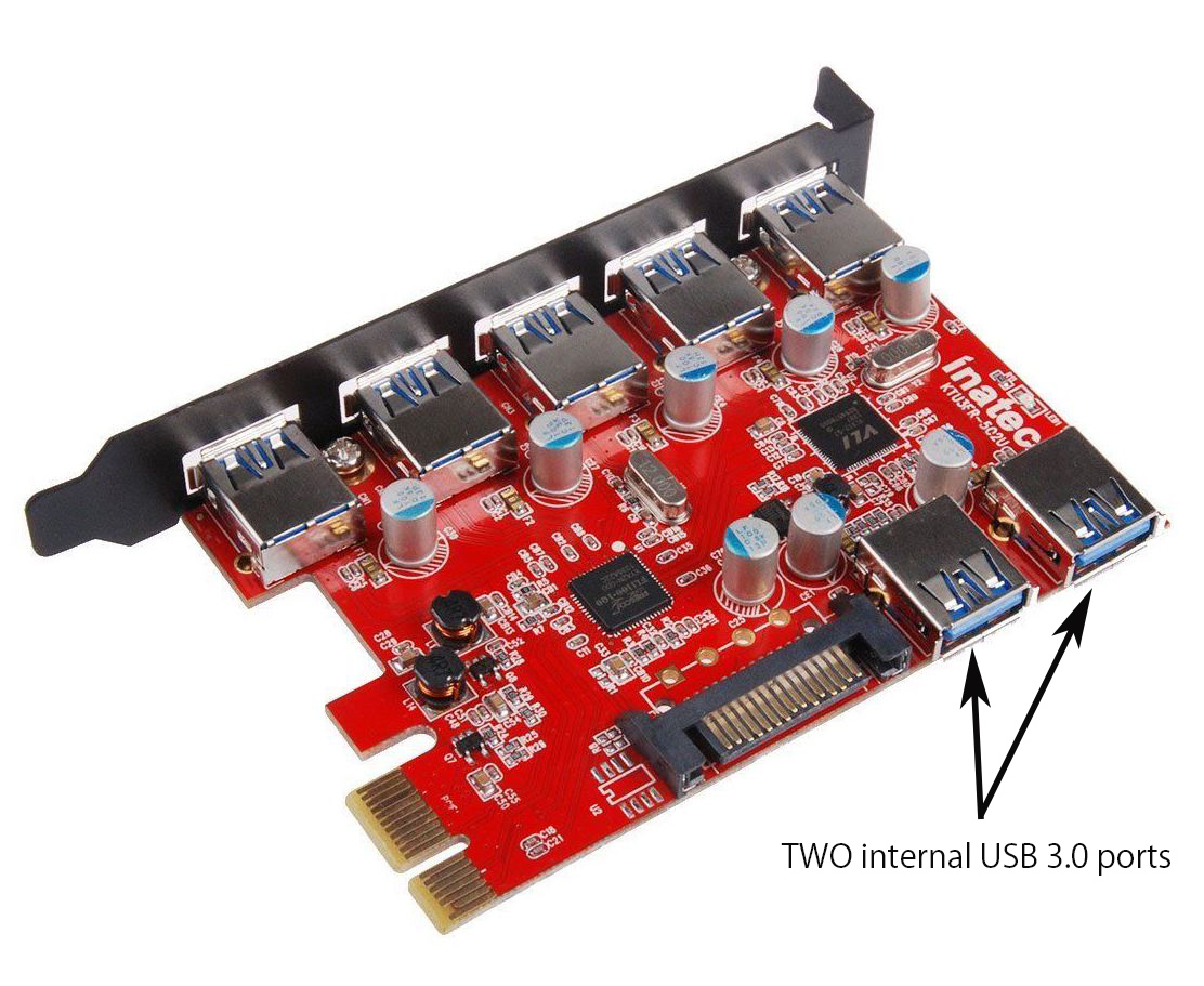

Not completely satisfied with the above . . I have ordered an Inateck SATA powered 7 port KTU3FR-5O2U PCIe USB 30 card. ( US$ 27.99 ) https://www.inateck.com/inateck-ktu3fr-5o2u-7-port-usb-3-0-pci-express-card.html
Two of the Inatek's 7 ports are internal which will allow me to power the two USB fans internally. Using this card I can replace my 4,1's original side cover.

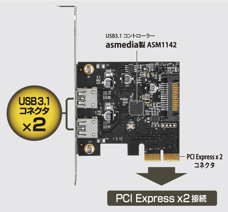

I now use a SATA powered Century CIF-U31P2 Two port USB 3.1 card ASM1142. PCIe link width X 2 for my external 3.1 Dock ( two HDD ) with it's own power adapter. Works OOB in 10.14.6

MIKX, I really appreciate your thorough and analytical approach to Northbridge cooling.
One of your main concerns with Northbridge heating seems to be that of its effect on the Northbridge heat-sink rivets. I would suggest replacing them with stainless-steel screws and nuts as shown HERE. Totally failure-proof, totally effective and less than $1US.
For dust removal, I take my cMP down to its components every 4 to 6 months or so, clean everything and reassemble. It keeps me in touch with everything about the machine. And it's kind of an active-meditation that makes for a very pleasant afternoon for person with my admittedly nerdy proclivities.
Thanks again for a very detailed look at this aspect of device cooling.
