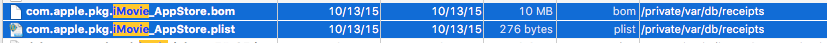

Try deleting these two files. That should allow you to reinstall it.

Ended up just deleting the two files (plist & bom), reinstalled and away we go.
