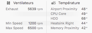

I installed the Monity software to check on the battery status and overall temperature, which made me realize the fan was constantly running at around 1200rpm (which is the minimum I believe?) even when the CPU was hitting more than 80°C (with no app running) and the top case was clearly hot.

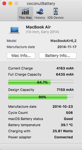

The battery status however shows "Replace Now", which contradicts Coconut Battery's diagnosis:

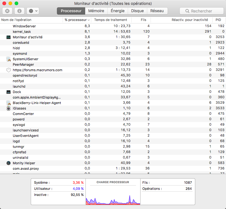

Could be a combination of issues - failing battery and some runaway processes. If the system is working harder than it should it's going to pull more power, and if the battery can't keep up....
Open Activity Monitor and keep an eye on CPU utilization.
I'm not an expert on coconutBattery, but the difference between "poor" and "replace now" could be semantic. Apple's likely to err on the side of caution and have you replace a "poor" battery, while users of 3rd-party utilities are generally looking to avoid spending on new parts. A utility that encourages premature spending might not sell many copies.
Reactions: bernuli
Your battery has a later manufacture date too. Mine is early 2014 and the date is April 29, 2014 with battery count of 195.
Still, even with 506 cycles, your battery should still hold a decent charge until at least 1000 cycles. Based on the age of manufacture, your MacBook Air should still be under AppleCare.
Here is my Activity Monitor:
I will check it regularly along with the temperature. They both look normal for now. Maybe I should have done that during the overheating episode.
And sorry, I misspoke about the CoconutBattery results: I wanted to point out that despite having the symptoms of a close-to-death battery, it is still showing a decent full charge/design capacity. And just as Johnny365 said, it is half the estimated cycle count limit claimed by Apple for this model.
