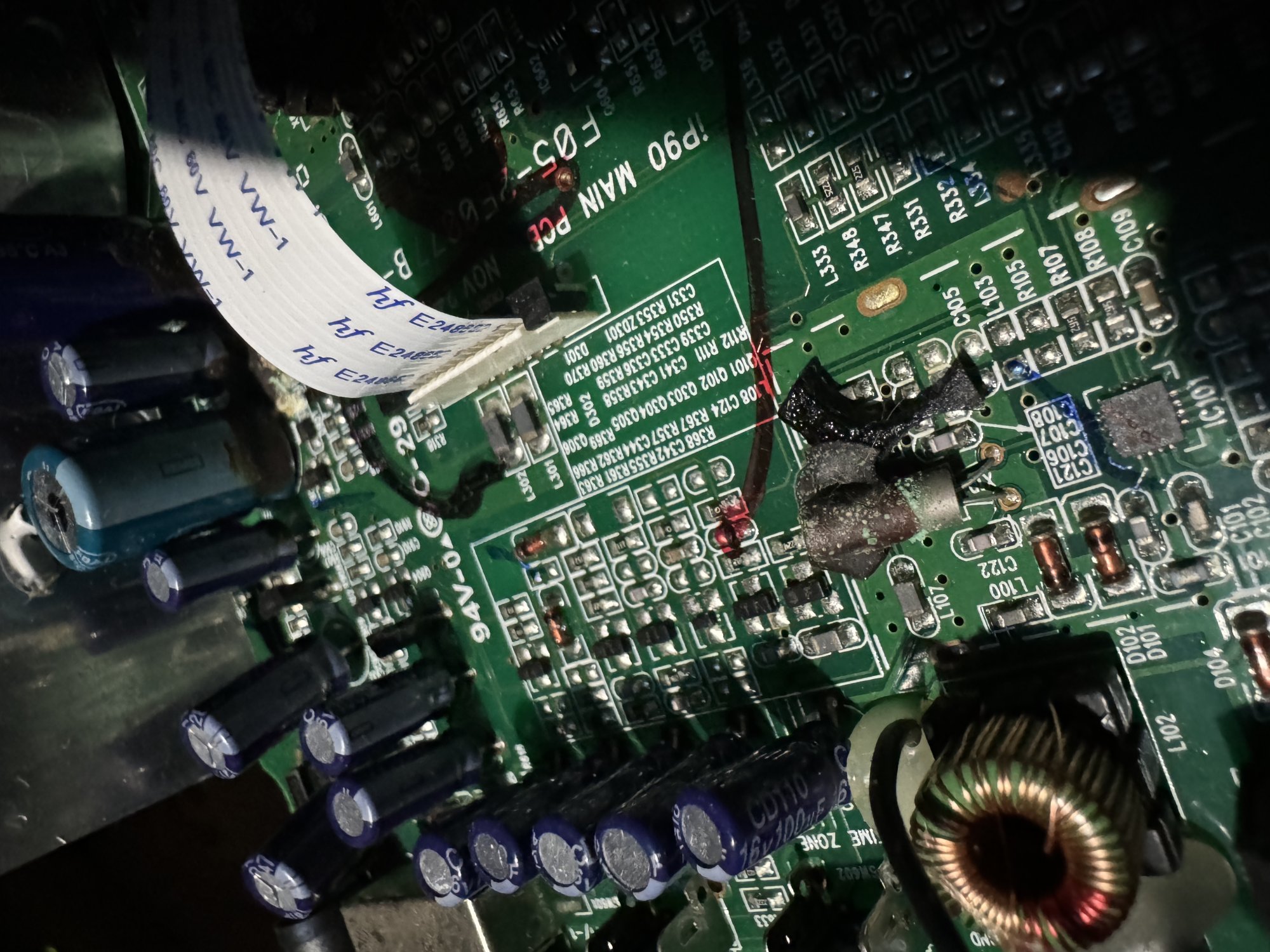

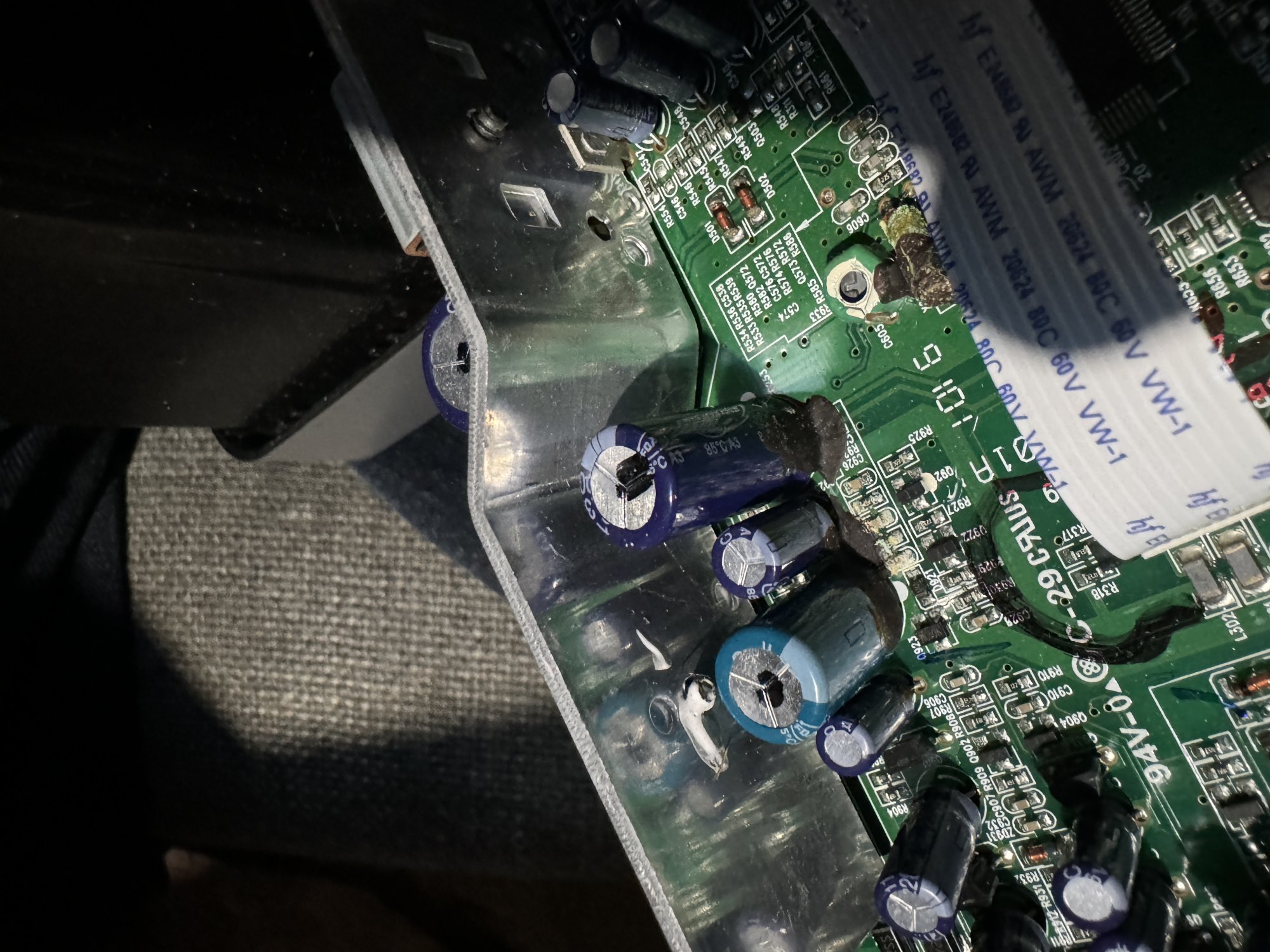

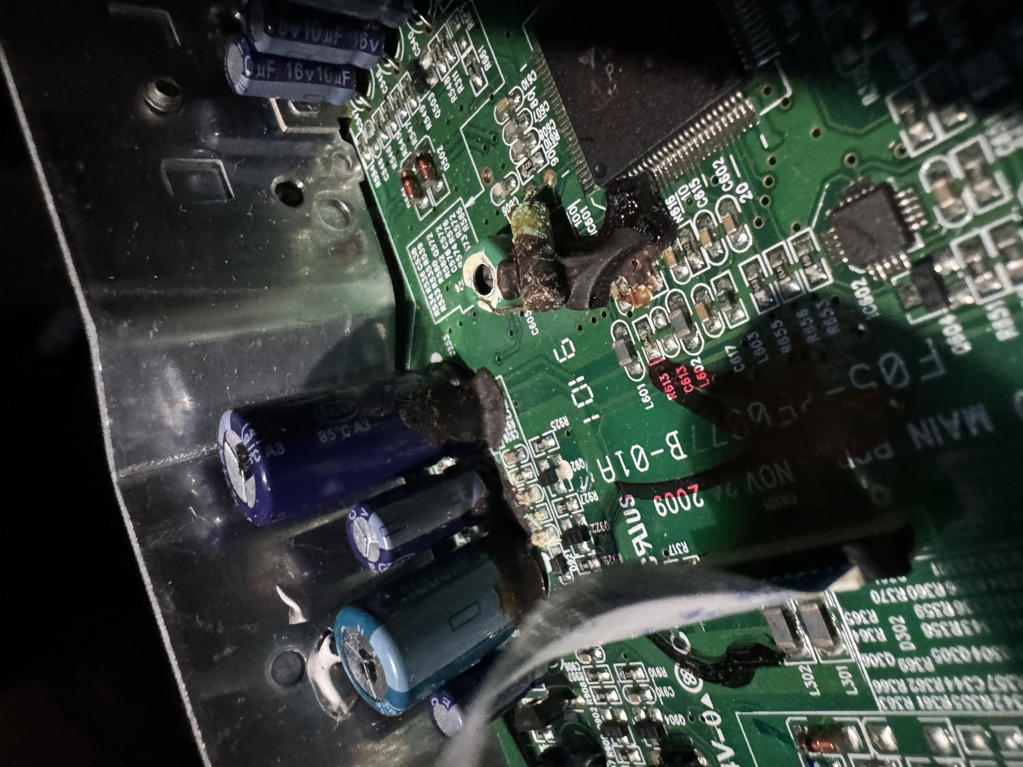

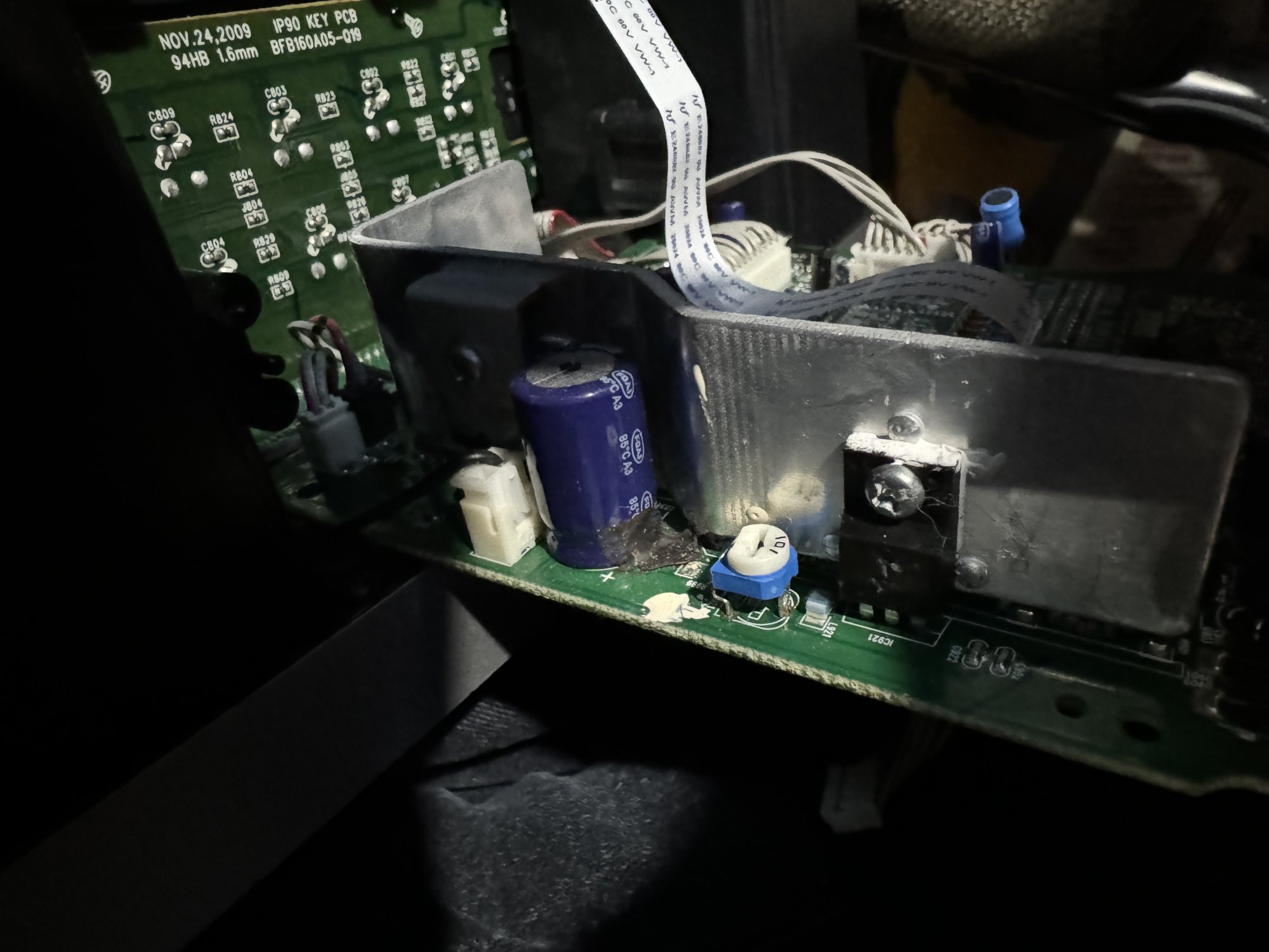

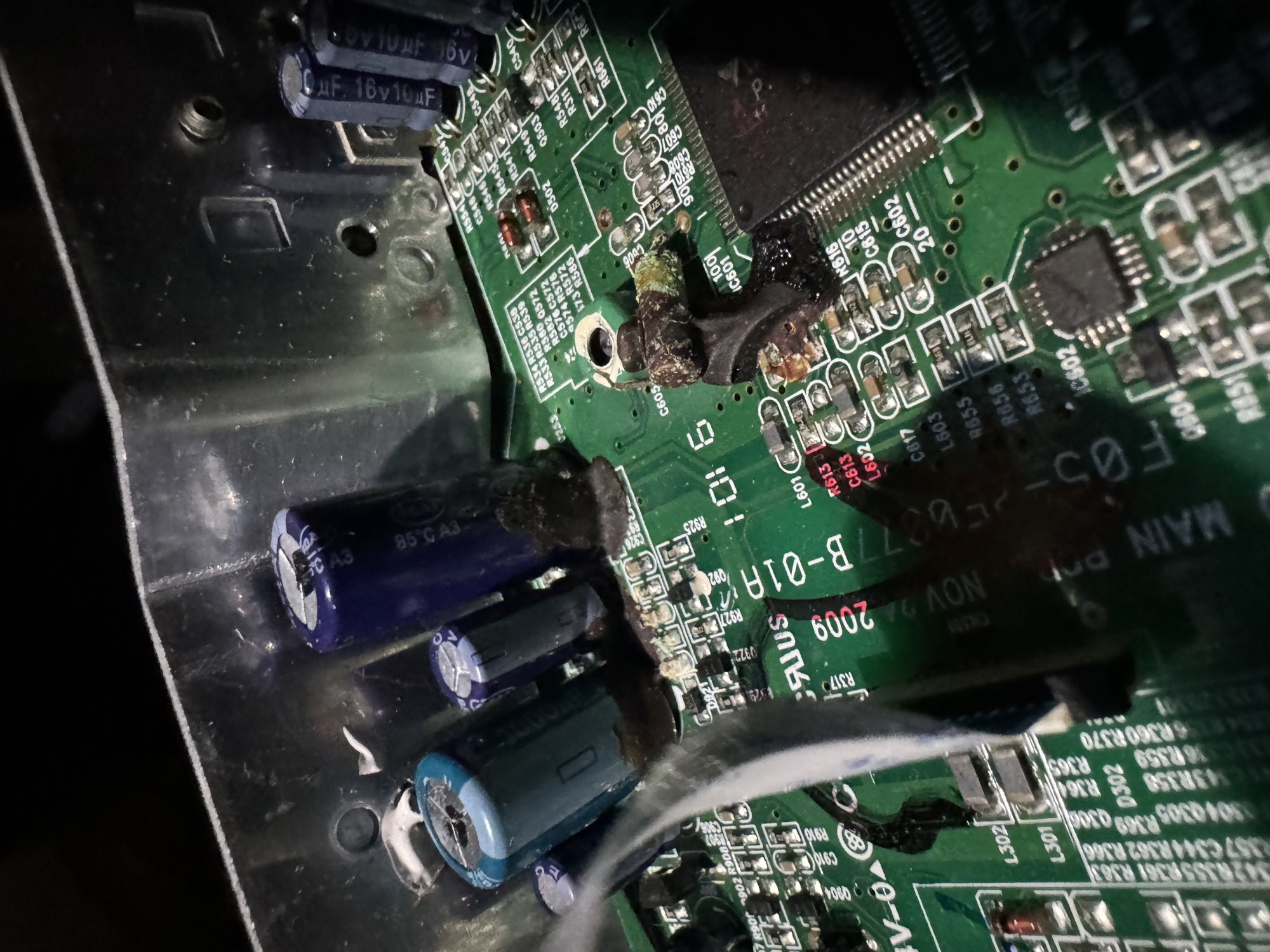

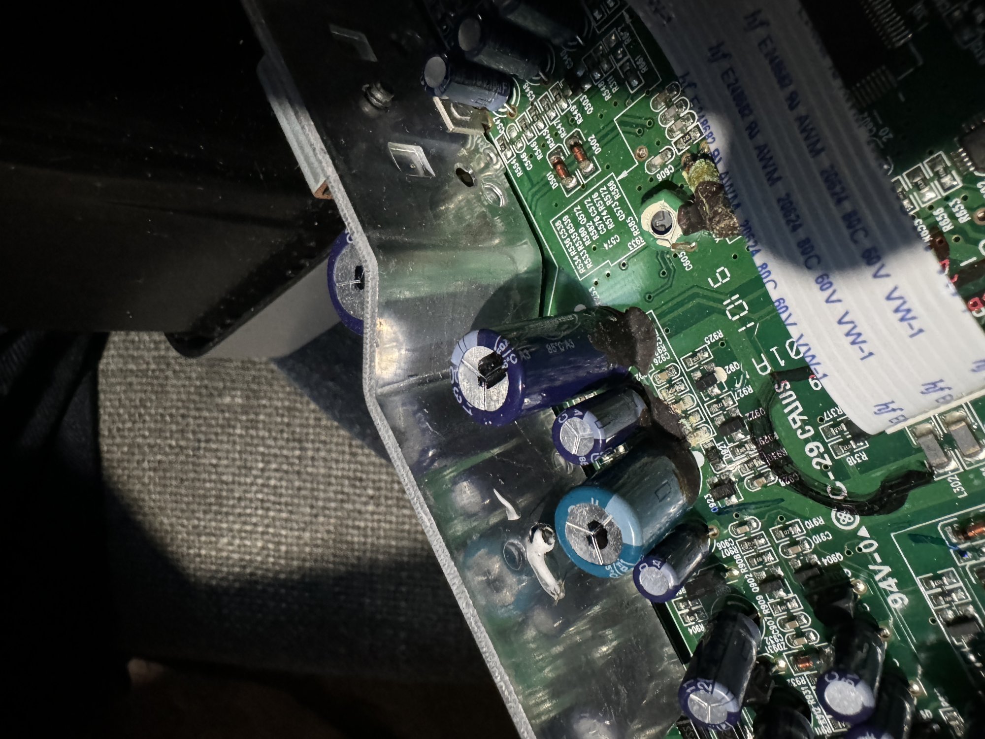

i have found there to be 6 caps that need replacing in my ihome ip90. anyone have shots of their main pcb board so i can identify 2 of them. ?
