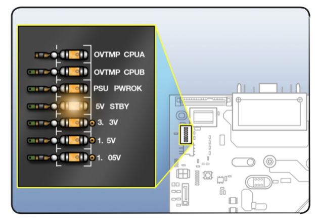

There's like a dozen diagnostic LEDs so just saying one of them is flashing is not very helpful. What is the label for the LED?

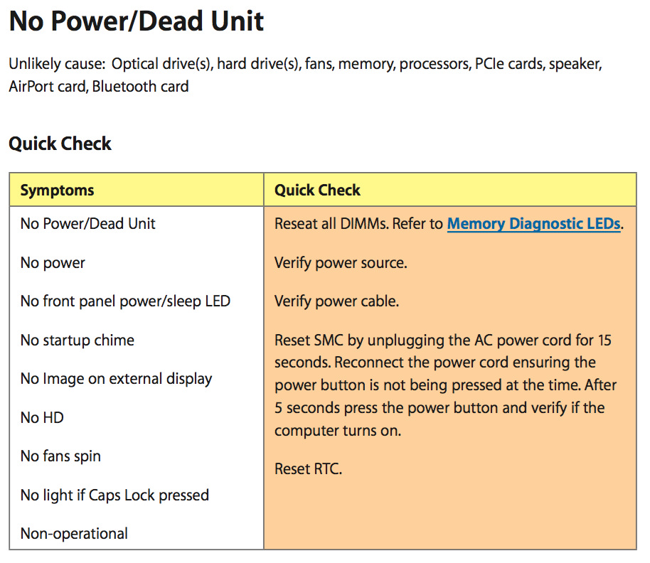

I suggest following the "No Power / Dead Unit" troubleshooting procedure in the service manual.
Which diagnostic light is blinking?
What happens when you push the DIAG button below the LEDs when off?
What happens when you push the DIAG button and press the power button?

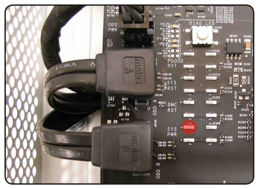

location of blinking red light
with the side of the case off you can see it just under the cd/dvd on front/top edge of the back board. No I did not press the DIAG, I did not know to. Thanks hope this helps.
First step:
Press DIAG LED button while power cable is connected:
If the STBY LED does not illuminate when you press the DIAG button, verify the power supply No Power symptom chart:

blinking red
the blinking light is farther up... at the top left corner of the backboard... out of the photo you placed.
yes
I think it is one to the top two........ I think it is the second one down. The computer is not in front of me .........

So, if it is one of two Over Temp Lights (OVTMP CPUA/B) you should check any build up dust in CPU heatsinks and remove heatsink and reapply thermal paste.
Do you know that fans were working properly before this problem ?
This is optimistic, but in reality OVTMP CPU probably means dead logic board.
