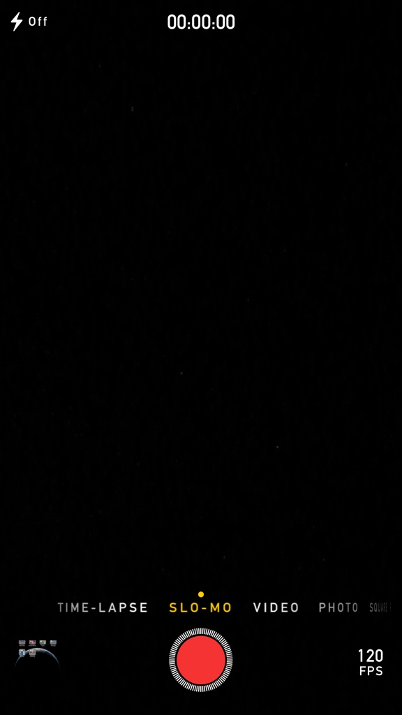

I'm also having the same issue. iPhone 6+. Not sure if it will show up in a screenshot, but here is a screenshot anyways:
Call Apple. When I called the senior advisor mentioned to me that they had not seen this in any of their csses. I even emailed him a sample video, which we acknowledged showed even exactly what I was talking about. He told me to hold onto the phone for a little while longer since it may be software related.
I restored the phone and it still did it. I believe it is hardware related.
