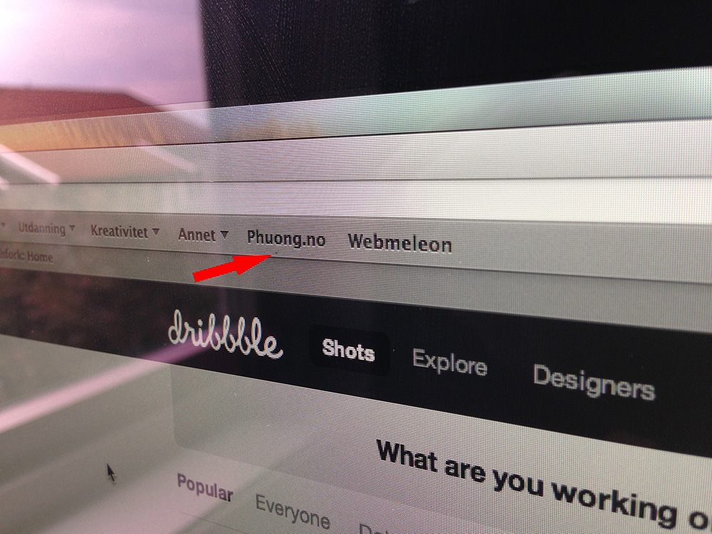

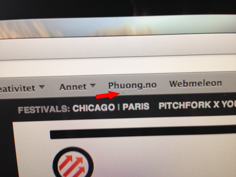

I purchased a 27" iMac late 2012 in April. The first one had a dead pixel, so I returned it. The second one had a dysfunctional disk, which made it crash every 10th—15th minute (also after a clean install). I returned it, too. My third iMac had a dead pixel — that's what I thought at least. But I decided just to keep it, although I hate dead pixels. It was my third iMac after all.
But, as it turns out, I noticed today that the "dead pixel" moves around depending on the viewing angle. Technically, it therefore can't be a dead pixel.
So, is it just dust under the glass? And is there anything I can do to remove it?
Edit: Added two photos. Notice how the black spot is moving from below the "u", and then to below the "o", depending on the viewing angle.

Thanks for reply. About the hole in the background light, I don't actually think that's the reason — at least for my display. It's a black dot just a fraction of a period. It's the same size as a pixel — just a tiny, little dot. I've had dust on the surface of the display multiple times, that I've thought was a dead pixel, which I could just remove with my finger. This one looks exactly like that, but it can't get removed.
It's definitely dirt. However that amount of paralax shift would appear to indicate it is far infront of the LCD itself. I know this sounds daft, but are you 100.000000% sure it's not dirt ON the screen. Have a really thorough go at cleaning it. I would even try a razor blade myself, but you may not want to do that. There was some other guy came on here a while back with a similar problem and although he was sure there was nothing on the screen, he later found that was not the case and he cleaned it off.

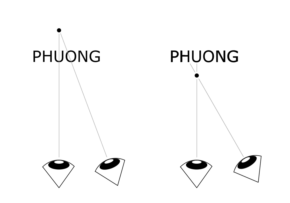

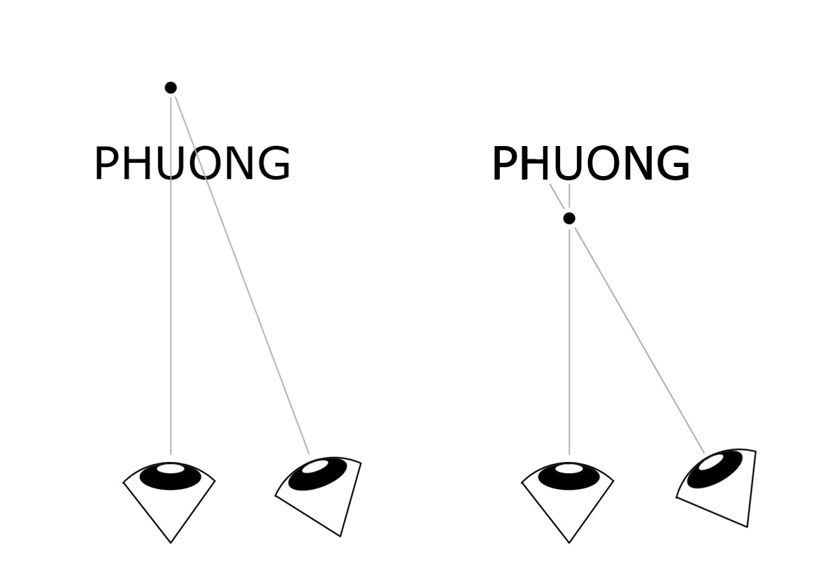

Before you spend ages polishing the glass to try and remove the speck of dirt, I should point out that whatever the problem is, is definitely BEHIND the LCD (see attached explanation).
I suspect it's dirt on the backlight.
Thank you! Great explanation. Now I won't wipe it in hours, like I did yesterday.
You are correct. My mistake.
I was getting ready to make the same reply as yours... but I would not have used the graphics... which makes it obvious. Very nice job!
/Jim
I didn't know if I was being a tad nerdy with the illustration - glad it was appreciated.
