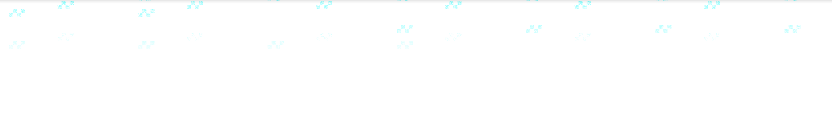

hello everyone. Ive been having issues with my mac lately. I have attached some screenshots of my desktop. At first i believed these were dead pixels but it seems not to be, the reason why i think it is something else is because when mirroring my screen on something like chrome cast this discoloration still is on the mirrored screen. Now this new thing just recently appeared, it is the same "dead pixel"but this one follows my mouse around. The pixels also tend to smear when you drag a window into them.. Any tips and advice would be appreciated,
Periodically positioned graphic irregularities is usually a sign of defective video RAM and can be caused by overheating.

Something is going on with your GPU. Did you have any information on what year and what specs your machine has?

this app is really helping! my computer has always had a heat problem. Now if i replace the ram will the graphic discolorations go away?

It's not too likely that adding more system memory will help your video artifacts, which may simply be the Radeon HD 2600 PRO showing its flaws.

so a new graphics card may be necessary?
I don't know that for sure.
If I had your iMac here, I would take the logic board out (the video card is on the back of the logic board), and make sure the big finned heat sinks on both the video card, and the logic board itself, are completely clean and clear.
In the event you need to replace, it's not too difficult. You would need Apple's part number 661-4663.
