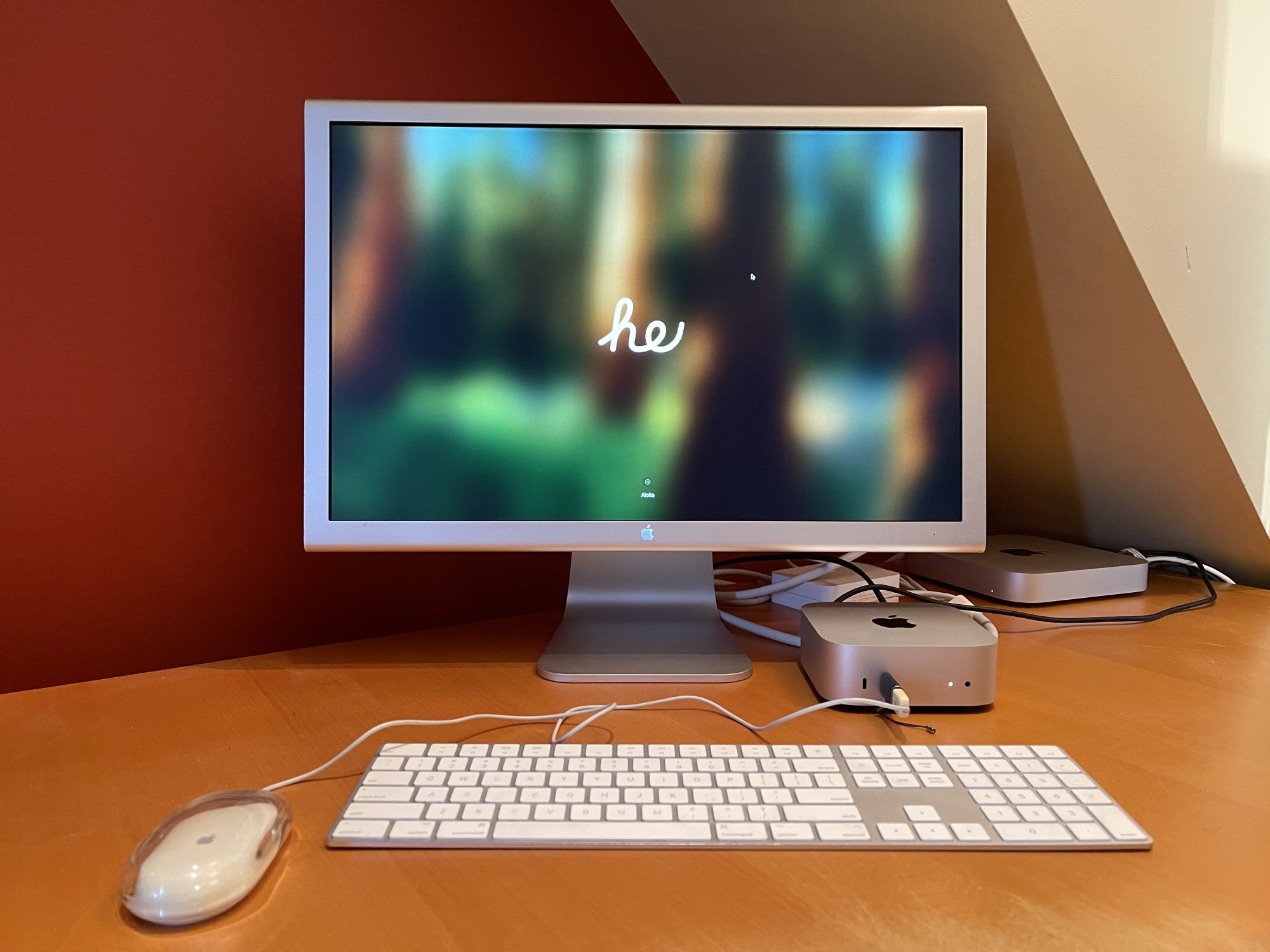

I have a 23 inch Apple Studio display that I was planning on using with my new mini, but when I was at micro center I saw they had the Dell 4k 27 inch model for $199.99 and I decided to give it a shot. I'm glad I did. It looks very good in "looks like 1080p" as well as in the higher scaled resolutions. In contrast, the studio display (1920 x 1200) looks worse than it did when connected to my old 27 inch iMac. I would have been pretty disappointed using that as my main display (but it's fine as a second). The dell is not as nice as the iMac was, but it's more than good enough for now. Well worth the cost.

Do you mean Cinema HD Display?
BTW, it's too bad the resolution is so low, because the design looks great with the M4 Mac mini.

Yes, that's the one. I still love it, but the lack of sub pixel rendering in the current OS makes it chunky at times. I actually have two, but one is the 1st revision and it's a bit less bright and has a bit worse contrast.
