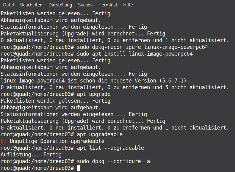

Hi,

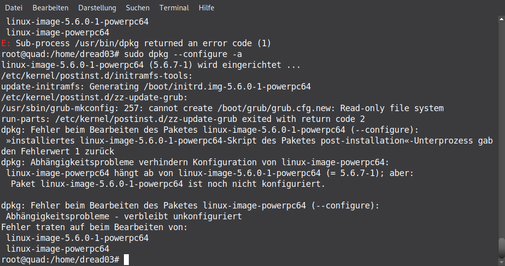

what i have done because of the read-only /boot/grub was:
used gparted to unmount the partition /boot/grub and than execute the commands.
Now all is upgraded....?
It looks like:
"linux-image-powerpc64 ist schon die neueste Version (5.6.7-1)" /...already the newest version (5.6.7-1).

Hi,
It looks like:
Seems like a strange solution, looks more like you encountered a bug. Can you reboot and still run Debian ?
I have done this several times. Now i have to reinstall libreoffice, because 4 pakets were kept back.
But no other error.
