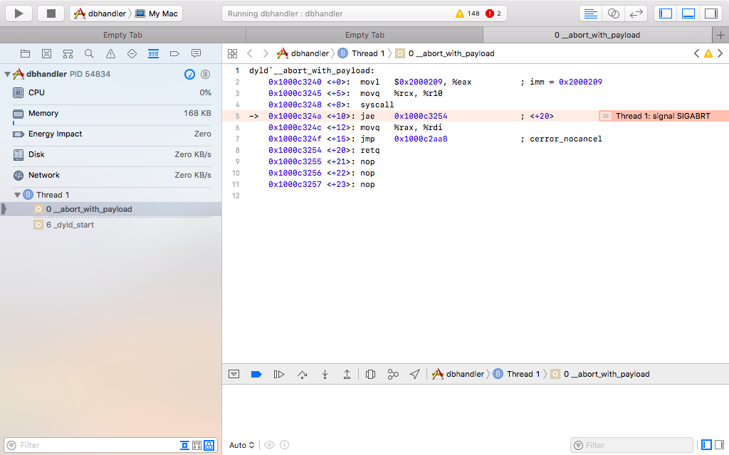

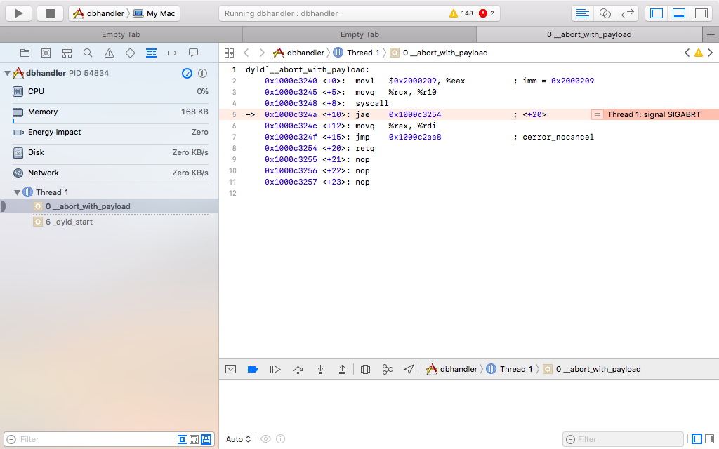

When the cursor jumps to the assembly, is there a yellow line with a little hamburger-menu-looking button at the very right of the line? Sometimes that can reveal more info. What kind of assembly is it faulting with? Memory access? A call to a framework/library method?
No, nothing like that.
See the screenshot below:
As you can see it stops on dylib call.

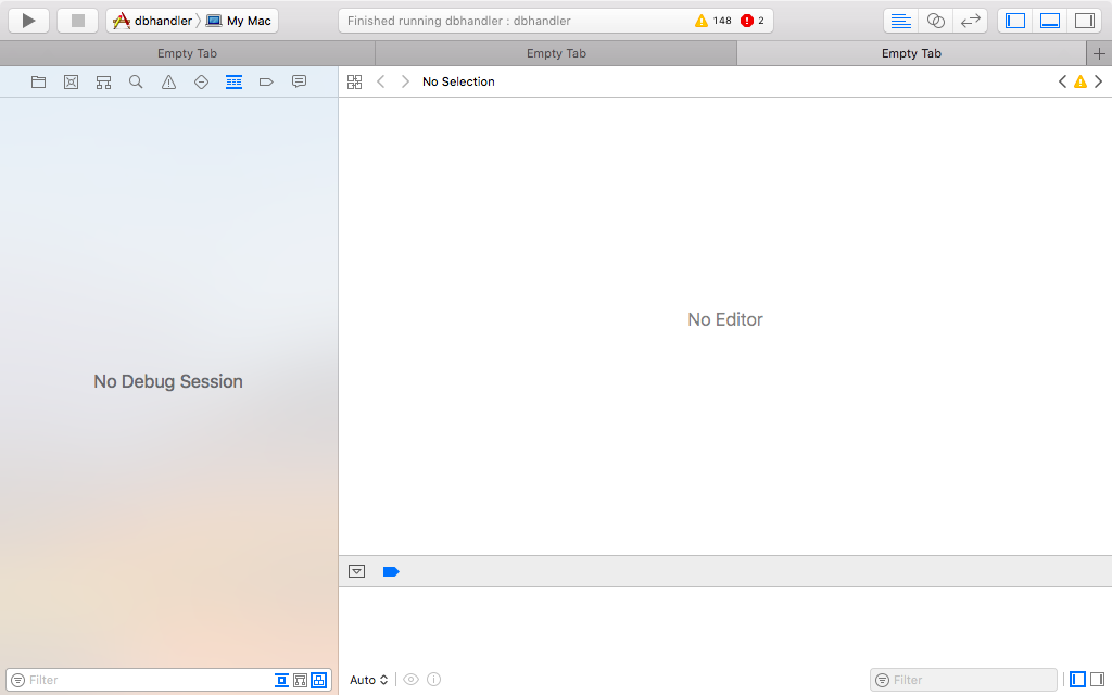

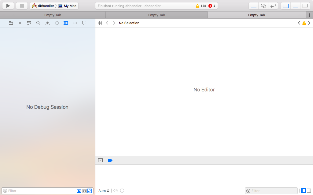

Anyway, below is the screenshot of my Xcode workspace:
What "schema" menu you are talking about?

It is crashing at runtime during during dlopen() call.

Hi, just woke up again. I'll probably try compiling it myself later,
Can I have a link? I tried googling dbhandler but found what I assumed to be other projects instead.
In the mean time, try this
If that works the issue is that some of the libraries your app depends on need to be code signed to work without the entitlement.

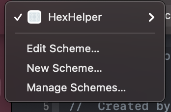

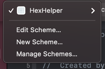

Regarding what I was saying about schema, it's apparently just called scheme. My bad.
It's the menu with your app's name, but I doubt there's any answers to be found there anymore. It would more have been if it were a build-error. Like if it just didn't know what to do when you hit build-and-run

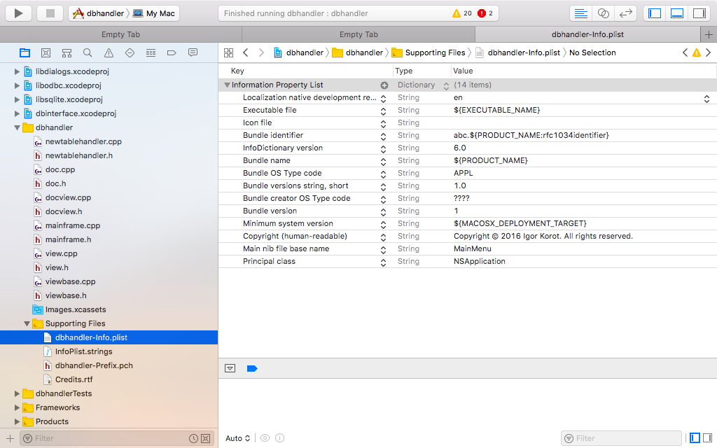

I presume it should be inside info.plist?
Should I add it there?
Let me know...

Regarding what I was saying about schema, it's apparently just called scheme. My bad. View attachment 1763115

Your screen shot shows a red stop sign in the top bar. This shows two errors. You can't build the project until you fix these errors. Click on this icon and the left pane will show the build errors. Correct them and build the project with command B. When it shows the assembly code it's showing where the error occurred. Set a break point in the code, maybe even starting at main(), and step through, or into, the code until you see where it crashes. Fix it.
Also the yellow warning triangle shows 148 warnings. The project will build with these but it's likely that it will crash when the offending lines of code are executed. Click on the yellow icon and they will be displayed in the left pane. It's likely that these are similar or identical problems. Fix them.
@Senor Cuete ,
Please re-read what I wrote in the OP and then come back.
Project is building fine as I can run it thru the terminal open command. The 2 errors you see is from the post compile script that copies all dylibs into the bundle and reminds them. They won't stop the program from running.
Warnings are just warnings. I'm aware of them. They will be fixed in time. But they will not prevent the code from running.

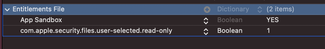

What I mentioned about the code signing should go into your entitlements file. This is my HexHelper tool's entitlements file.
An alternative way of testing the theory would just be to code sign the libraries you're using with your developer ID/local testing ID

What errors does XCode display when you click on the red stop sign icon?
You are wrong about warnings in XCode/Cocoa. These can be warnings of trivial things that you can ignore but often, particularly with Ojective C or Swift methods, they usually will crash the program. In XCode you should treat these the same as as errors.
It looks like you don't have the lower right pane split. If this is visible you should see variables in the left half and logged messages and errors in the right.
