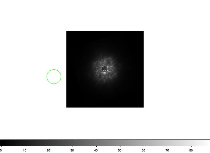

A quick note before the plane departs. The original code called match four times with the same data as now incorporated into the structure. Match was a float and returned sd to the original program. In principle, Ive combined all the data into the structure and sent the structure to match. Instead of returning sd, match now is supposed to put it into a structure.
Run only one thread 5 times still gives different results each time I run it.
I've attached what should be the original code with sd of difference as one routine instead of two.
I take two images; a quarter of an annulus of one image is compared at different magnifications with an other. The standard deviation of the difference between the two images is returned.
There are four structures, the output is stored in the structure send to the thread. I would think that is sufficient.

Just calling match without the thread returns the same result each time but for some reason has stopped looping.

It doesn't seem to be the output since sd_of_difference returns different values which suggests something with the input images
