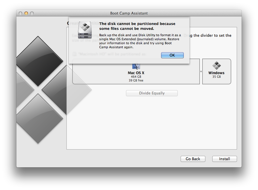

I backed up everything after all, but now I've run into a problem.
Does it mean I have erase all my information and then put everything back?
I recommend doing a time machine backup, erasing the drive, then restoring through time machine the whole system. I vaguely recall there being an easier option for this error that you have, but I am not able to look for it at the moment. I will be able to tomorrow, however.
