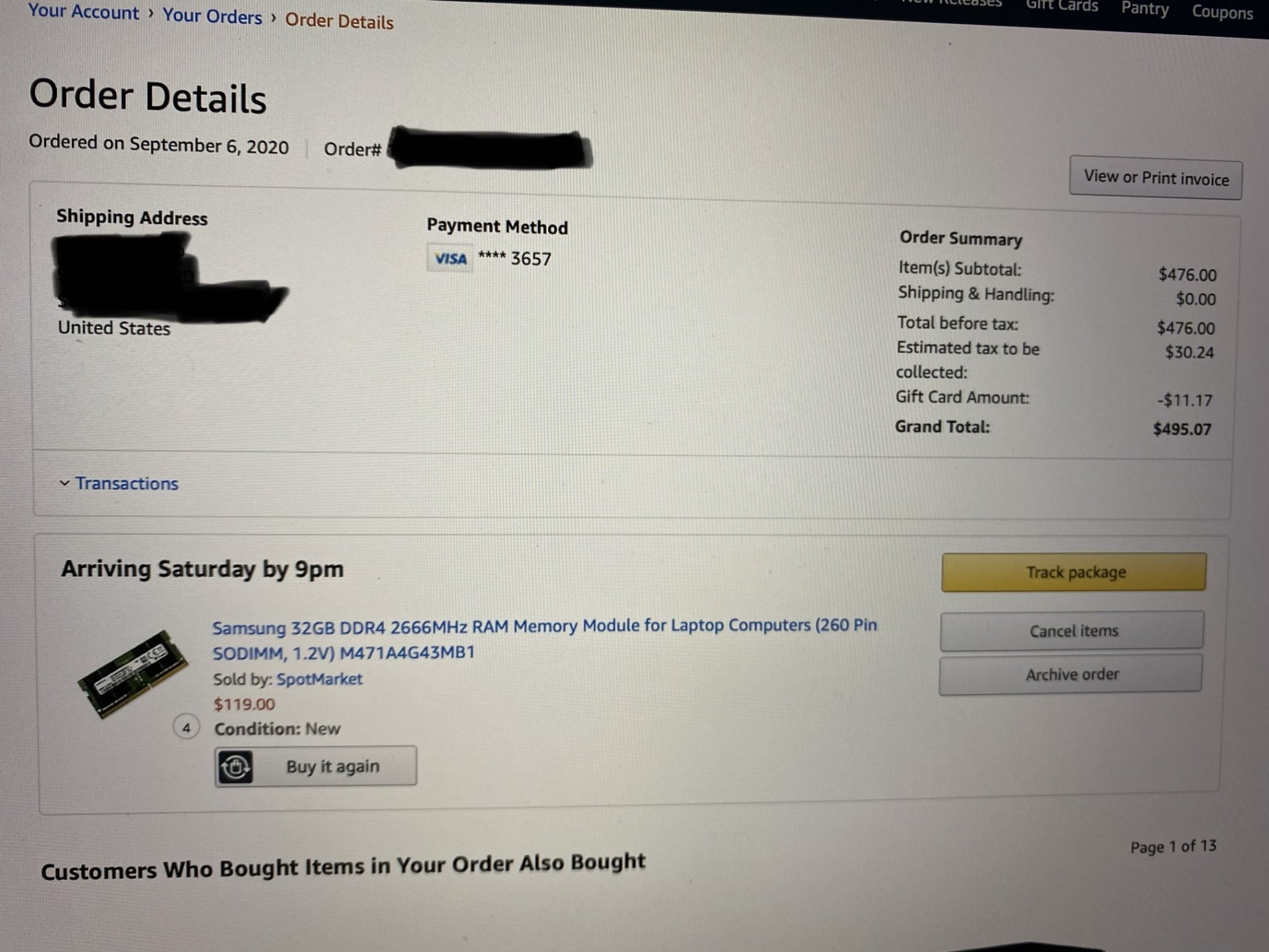

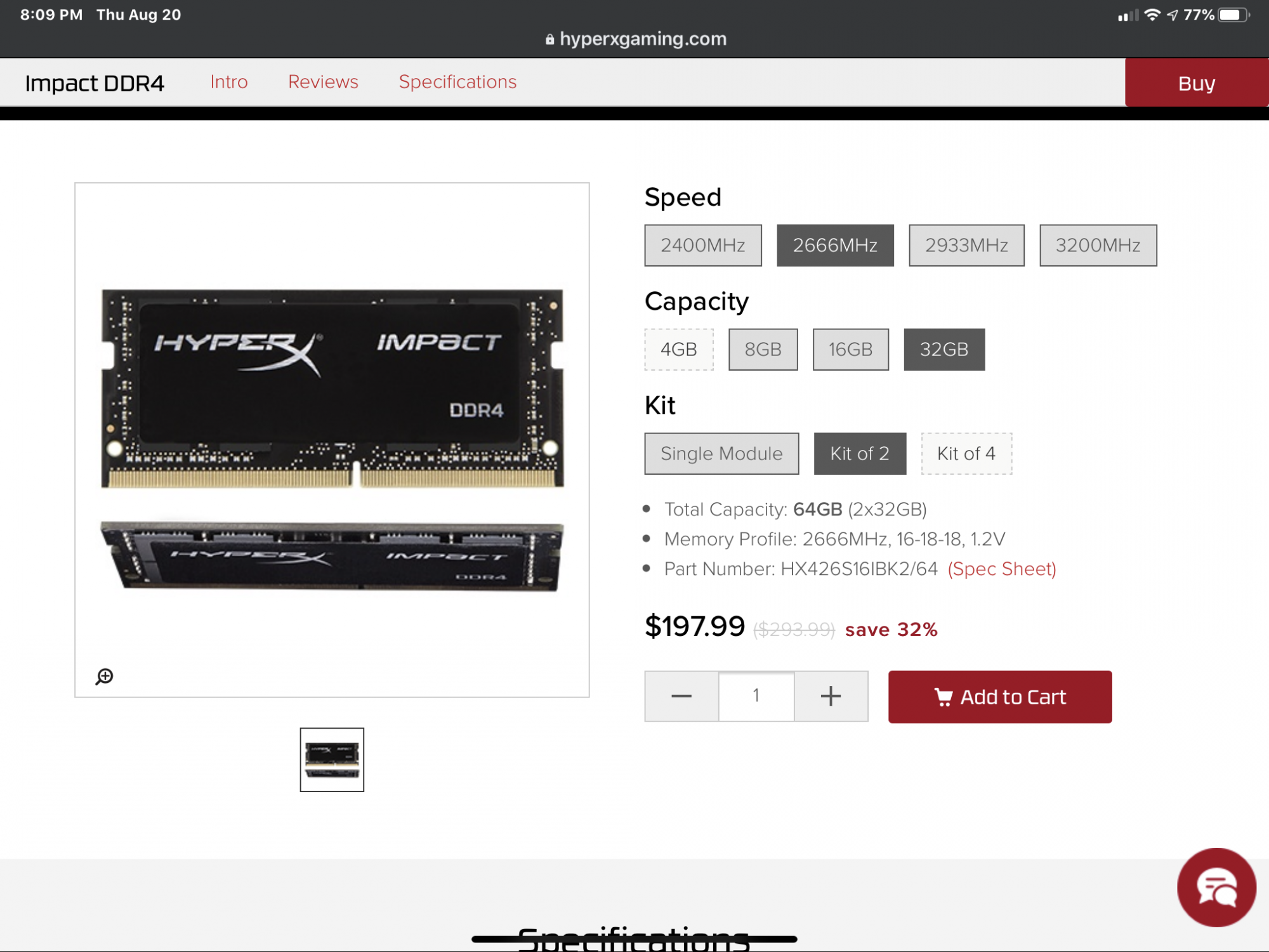

Hey ZBoater, just so you know I ordered 128GB RAM for my i7 iMac. I know it's beyond overkill but you know, can't afford that i9 right?
Sorry you got suckered into overpaying for your RAM. But I guess you have all that extra cash from downgrading to your i7...
Bummer. It looks like HyperX is out of their 32 GB chips, which would have saved me about $25 each from the Timetec chips from Amazon.
