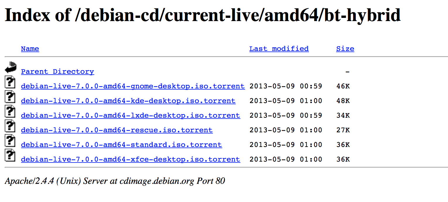

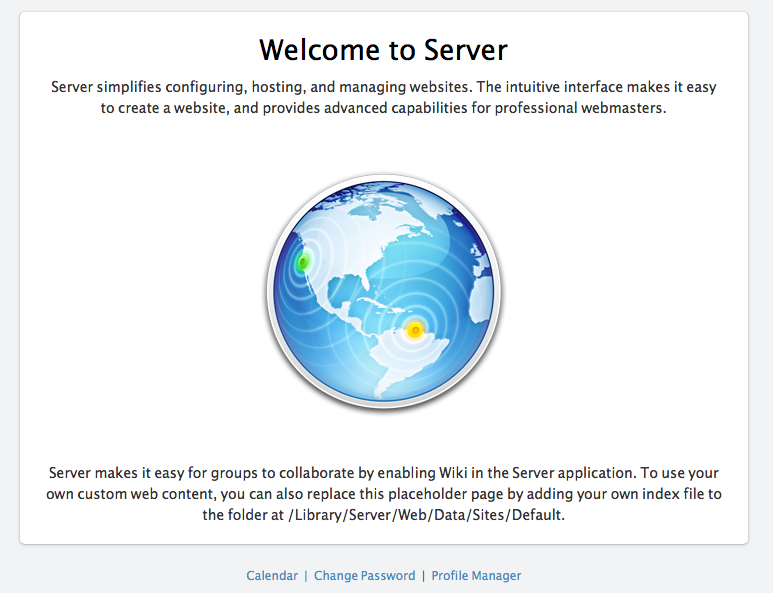

Hi. I have just started a server using OS X Server 10.8. I have already set up AFP and SSH sharing and now I'd like to configure HTTP sharing too, so that surfing to 192.168.1.XXX I can access and download my files. What I did probably worked, because surfing to 192.168.1.XXX I can see this page:
I browsed to the indicated path and removed the sample content of the "Default" directory, and now I'd need to edit the "default.html" file. I'd like to edit it so that surfing to 192.168.1.XXX I get an index page like this:
...but how? I don't know much about html and servers, can you help me please? Thank you.

Out of the box, Mac OS X Server's (10.8+) comes with quite a bit of configuration. The base configuration file should be located at /Library/Server/Web/Config/apache2/httpd_server_app.conf. This sets up the core apache configuration, but it also contain includes to other .conf files which provide further options. For your purposes, you are going to be interested in the configuration files located in /Library/Server/Web/Config/apache2/sites/. There should be a file called 0000_any_80_.conf. This contain the VirtualHost configuration for *:80, which means any listening interface port 80.
If you look inside this file, you should see something like:
