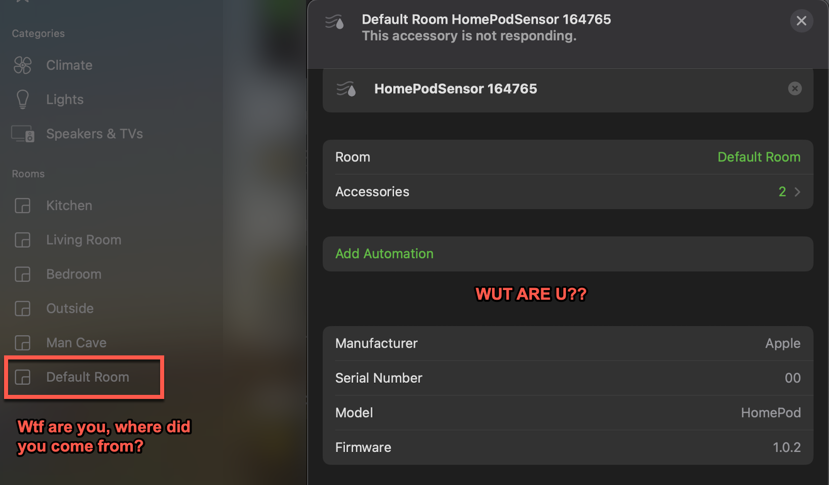

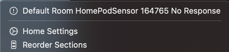

This is an alert that showed up at the "home" level in the Home app (current macOS and iOS alike).
My question is: WTF is this thing, actually?
So this "Default Room" cropped up out of the ether I guess. I did not add this room to the Home layout, ever. It has no actual devices associated in it, except for temp and humidity sensors which of course don't have any data (and are probably the source of this "not responding" message) and make me believe HomeKit thinks I have a phantom HomePod there.
I'm not using Matter, either. I do have a bunch of Eve Energy devices deployed which have been pretty solid -- ironically until this morning which is doubly ironic because Eve pushed out version 6.0 of their app with support for Matter-enabled devices just yesterday. I didn't even so much as open that app though, much less upgrade anything at all to Matter.
Has anyone else seen this? I will just remove this "Default Room" if it lets me but I thought this was worth sharing regardless.

And of course it's not possible to remove this room. There's no "remove" option in the room's settings.

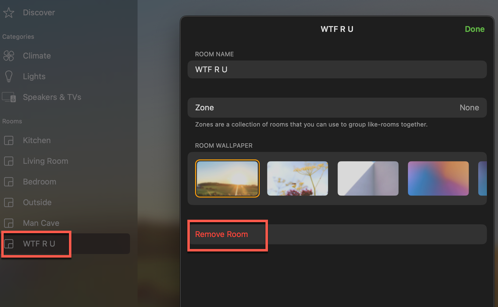

I wound up removing what that phantom accessory was, and that in turn removed the Default Room. Reboots and unplugs/re-plugs of the HomePods and computers did not remove it.

I was able to rename that room and magically there's a "Remove Room" option now.
What happens internally when you rename the default room is this: you are creating a new room.
and then of cause you can remove that new room. But then devices in that room are no longer assi to any room and show up in the default room.
The default room is where Homekit puts devices not assigned to a defined room.
Reactions: 3460169
It's the first room created in a Home. Most People rename it or it disappears if other rooms are added.
It's so that there is always a room for devices to fall into, should a glitch occur. Otherwise, they'd get deleted.
