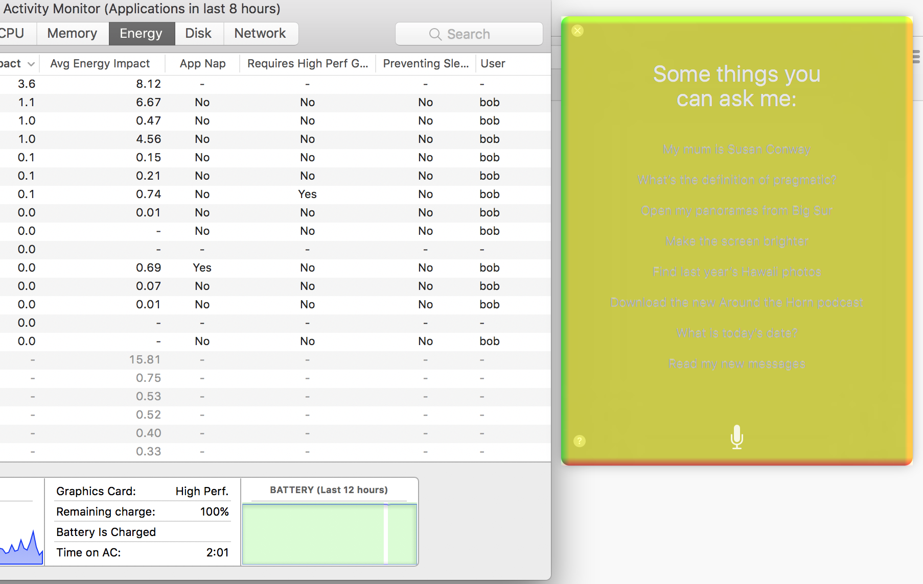

Hi, just wondering if someone with a new late-2016 MBP w/ Radeon card would try these simple steps to see if they get a graphic glitch?
Fire up Siri to do anything or nothing. Just make sure to leave the Siri window open.
Once Siri is done doing something or nothing, fire up Photos. Does the Siri window change to strange colours?
Notice in my screen caps that the "High Perf." card is running with problematic window.
Just trying to confirm if it's a problem with my new hardware 🙁. Or, software which they will eventually fix... I am running the latest 10.12.2 beta 6.
Thanks.
Thanks.

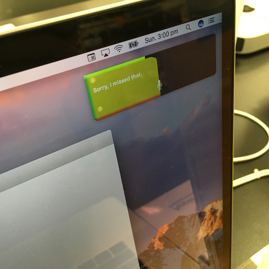

I was in an apple store yesterday to see the new mbp 15" late 2016 with touch bar.
I was wondering how fast it would open apps if I clicked a lot, so I did and opened like 10 apps from the dock after that I opened Siri and notice the exact same glitch, safari was definitely running.
Kinda laughed cause it is brand new and very expensive !!
Thanks.

I walked into a store today and tried the MacBook Pro 15" Radeon 450 on display (running 10.12.1) - yep, immediately did it after opening Siri and then Photos:
With a Safari window open behind it there were some red squares in the tab bar. I tried the same thing with the 13" MacBook Pro with Touch Bar next to it, but couldn't replicate it on that.

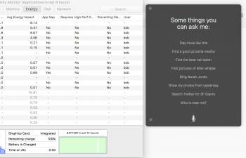

Its a bug in the switching of internal and dedicated GPUs, same happens with siri window and you click that "automatic graphic switching" option instead of opening photos app

So maybe those not having the issues are already using the dGPU when they run the "test"? That might be it.
