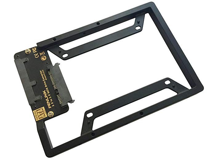

I put an SSD in my daughter's 2008 iMac a number of years ago. Hers dual-boots into El Cap and 10.6.8 for an app she likes that was never updated further.
All you need are a few tools, the drive and one of these brackets. Replace the BR2032 battery while you're at it. These are very easy to do.
