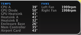

With my MBP warmed up here are my temps. Though my iPhone is plugged in so the temps are a bit higher the usual.
I'm not sure high operating temperature is a reliable indicator of a defective unit. Intel mobile processors are designed to operate at up to 100C. I don't now what the max operating temperature of GPUs are but it would probably be similar, especially seeing that Gigabyte sells a passively cooled desktop 8600GTS that runs at 99C under load.

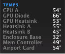

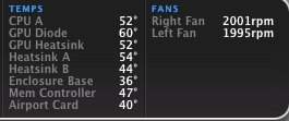

Computer was in sleep mode and I just come home, sent an email and looked at the thread. This MBP is 2 weeks old.
I'll post a stress image in a little while.
