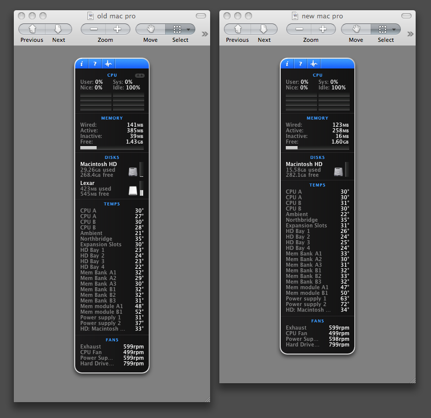

These power supply temperature were taken while idling:
[Mac Pro A]
Power supply 1: 63C/145F
Power supply 2: 72C/162F
Would you say those temperatures are a little bit high?
Temperatures taken from another Mac Pro under similar
conditions:
[Mac Pro B]
Power supply 1: 31C/88F
Power supply 2: 37C/99F
Thanks.

Here's a comparison between the old and new machines:
Some variability I would expect. But a 30C+ increase is rather
dramatic 🙂

I've sent some links and a comparison screenshot of the current and
previous MP readings. Alas, in an Apple email:
"As Apple does not recognized any application to measure the temperature
I cannot say if this is normal or not."
