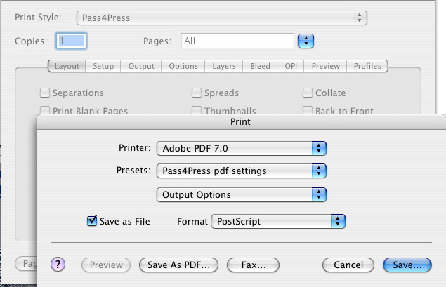

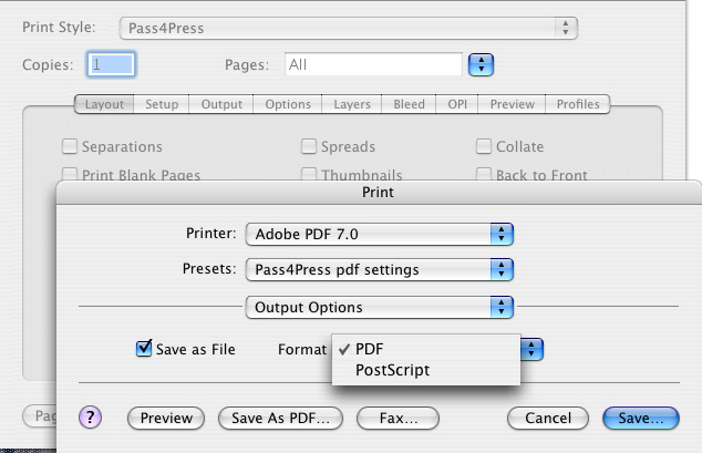

Ok, managed to have a pop and despite making sure I have all the settings in the iMac, I'm still having problems.
It mainly revolves around the difference in where the various menus/dialogues take you in Panther and Tiger.

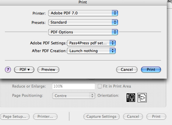

In the two posts below are screenshots of the same process, first on Panther, then on Tiger.

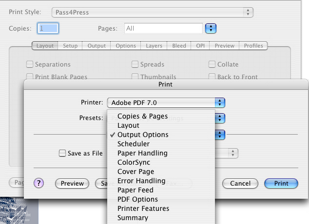

On Tiger, the first problem is the preset - there's no option to change it to my "Pass4Press" setting.
The next problem comes up when trying to choose "output options." This option simply isn't available in the Tiger version?!

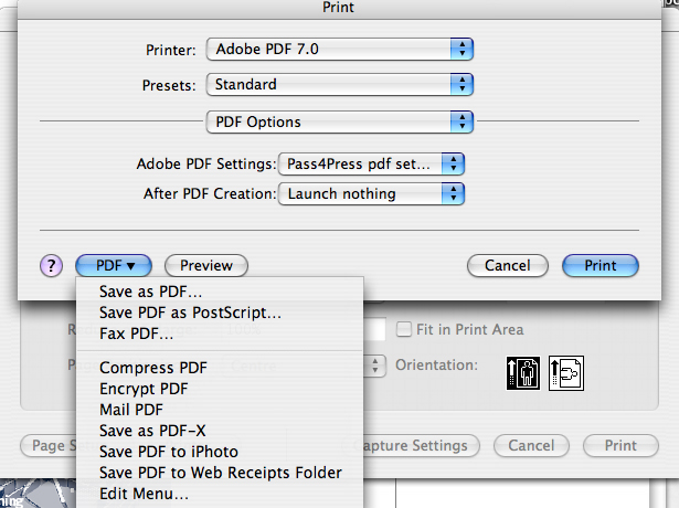

The next problem comes when trying to use the PDF menu at the bottom left. On Panther you have to check the "save as file" box and then switch the "Format" from PDF to save as "Postscript."
On Tiger it doesn't have this, but has an option to "Save PDF as Postscript."
Is this the same thing?
How about 'PDF Options'? And just ignore the PDF button on the left-bottom. That's a Quartz PDF, ewww.
Just hit print.
Just hit print.
