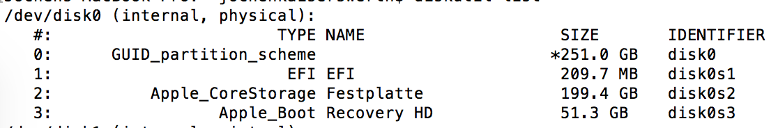

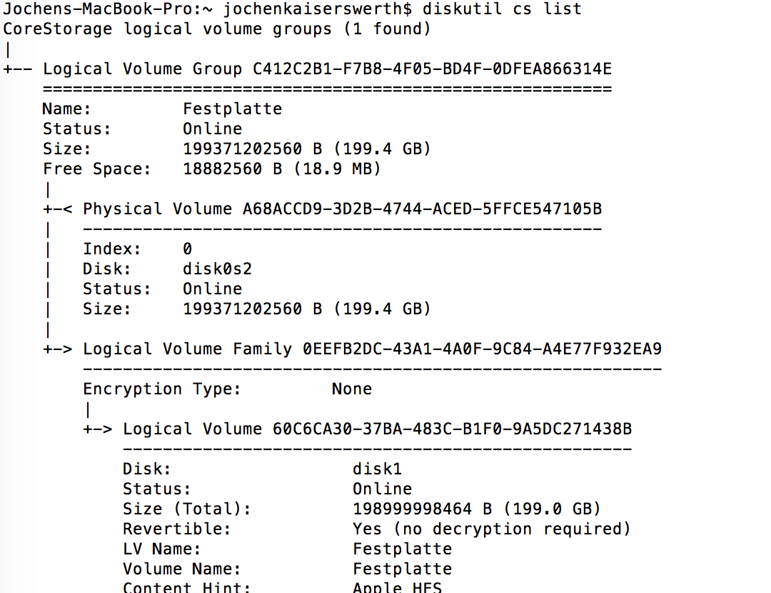

Run each of the commands below in Terminal and tell me the output of each so I can see how your partitions are setup.

Here it is:
… and …
What I notice here is that the Recovery HD has a size of about 50 GB!
Jochen

Here it is:
The issue there is that the El Capitan install converted your drive into a core storage volume that cannot be resized by Disk Utility. Run he command below to turn off core storage then you will be able to resize the drive.
Code:
diskutil cs revert /
I have no idea what is going on with that 51.3GB recovery partition though. I see this old post where Bootcamp made a 51.3GB partition, but it was not labelled as recovery like yours.
Do the convert then resize then and run the list commands again to see what we get.
