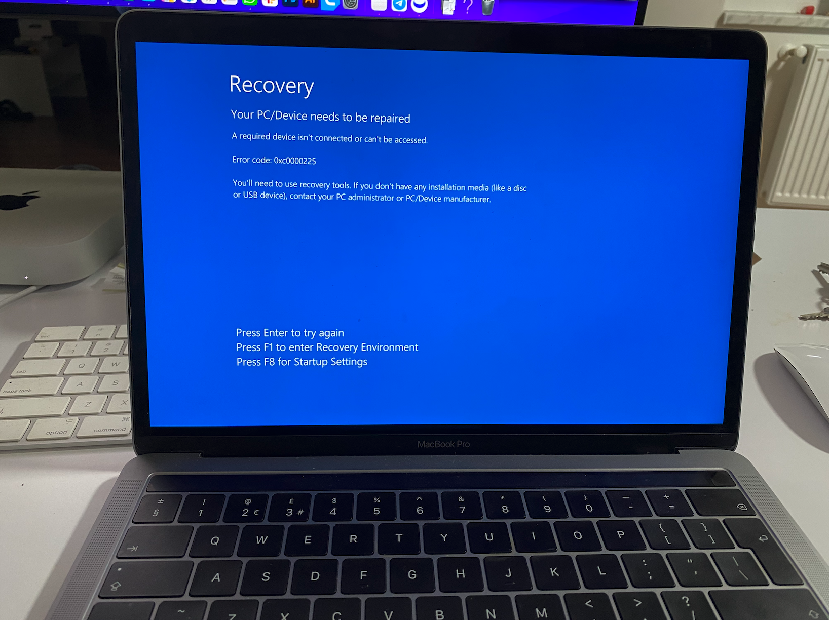

Hello,
I accidentally deleted Macintosh hd , now my notebook start with windows error ... any advice ? tommorow I will go at service with it, but lets hope I can solve it. Idk how to get acces to disk utility, I had windows on it, and I try to delete the partion with windows but deleted everything I belive.
MacBook Pro 2019

Did you try to hit F1?
The other things to try are to reboot holding down the Options key or holding down Command-R.
Yes, I try Command-R/Command **** R and everything else, its just reboot with this error, Idk where is F1 on Touch Bar FN don't work
It sounds like you deleted the recovery area too. My usual approach would be to create a bootable flash installer but you'd need another Mac to do this. It's probably easier to just go into the Apple Store where they will basically do the same thing - install off an external drive.
Ok, try Shift+Option+Cmd+R (sort of Legacy Internet Recovery Mode)
If no success – you'd better look after another Mac and USB stick (to install Bootable macOS)
After that hold Option(Alt) during startup –> select stick –>you'll know the rest)

I try every combination of keys, nothing works, looks like usb is the only way, I don't have a usb type C, so I will try tommorow , thanks alot

You didn't try option-cmd-R. It always works because it's not dependent on the SSD. You have to hold those keys until you see the spinning globe.

Option Cmd R does not work on M1 Macs. You have to press the power button and hold it down to get in recovery mode.

Good one, but I'm not sure if it's possible if Recovery Mode and its relation was corrupted (or seems so)
Target Disk Mode could not be even detected eventually)
Hm you could be right. I would still attempt it though because my understanding is that Apple Configurator 2 is supposed to be able to fix a device no matter how badly you screwed up the software/firmware. I think a restore actually re-flashes the firmware -- like the EFI and everything.
