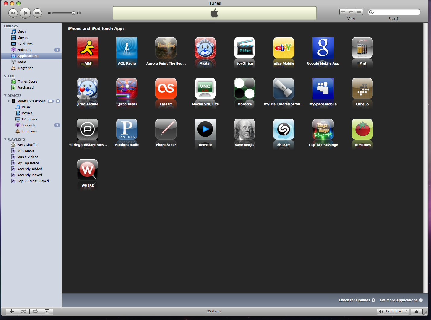

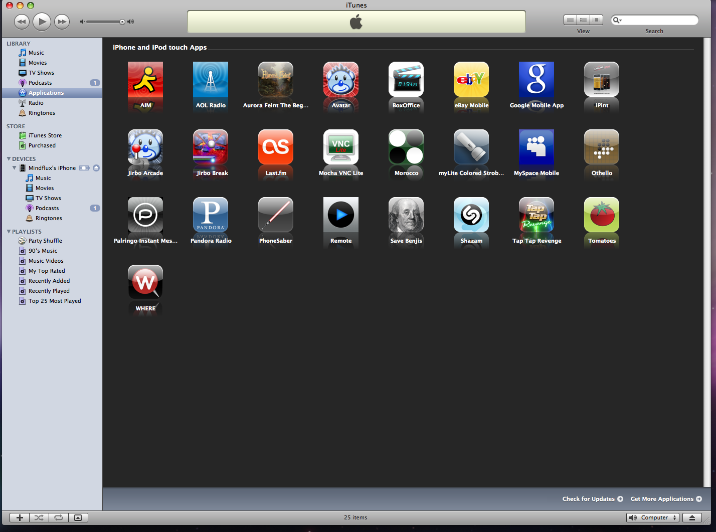

Yes, it is hard for some of us to understand. Would you please explain how one can delete an app from itunes.🙂🙂🙂
Go into the applications sidebar and delete the app.
If I uncheck "Sync Applications" in iTunes. Will it let me manage my apps entirely from the iPhone? Because that's what I want. I'm afraid to uncheck it though because it says its going to delete all my apps...
It will not delete your apps if you decide to uncheck that Sync Applications box. Your apps will remain and you can manage them on your phone.
